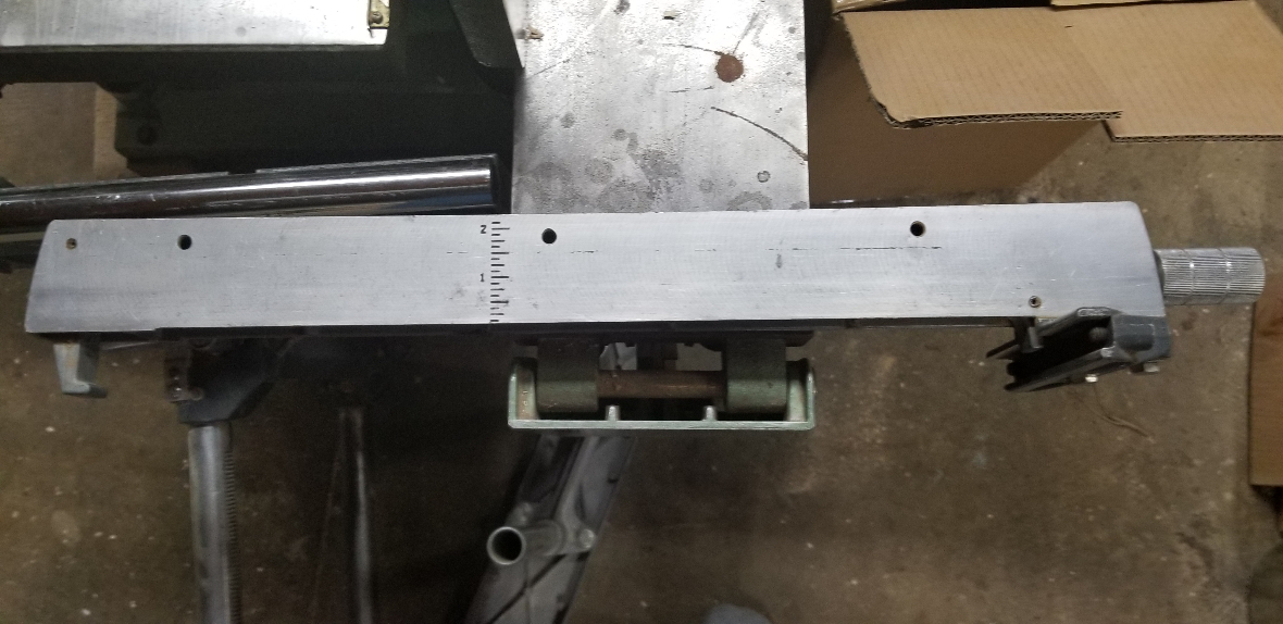

Re: 510 Table Saw - looking for tips setting depth & fence width
Posted: Thu May 23, 2019 10:10 pm
by Hobbyman2
The mkv fence is graduated with reference marks
The mkv fence has reference marks
