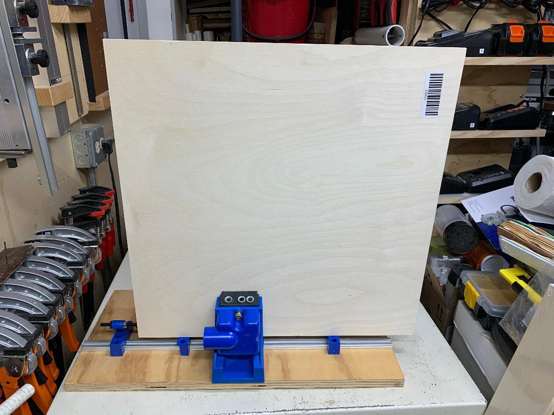

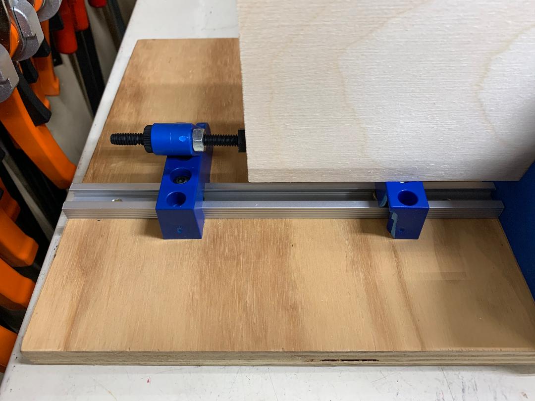

The only disadvantage of the one that I have is the lever being behind the work piece. On short parts or taller parts that aren't too long having the lever there is no issue. If however you try to do a part where you can no longer reach the lever from the front then it is an issue. In this photo it is still not a problem but if the piece were longer....
Now I mounted my jig on a plywood platform and added some mini track to both sides. Doing so allowed me to put these material support stops in place. I don't do much longer work so this size works well for me but if you were doing larger projects all the time then a longer base might be in order. These material supports make sure the holes are being drill vertical to the work piece. They also can be set up as stops to locate sets of holes the same over many work pieces. A nice addition.

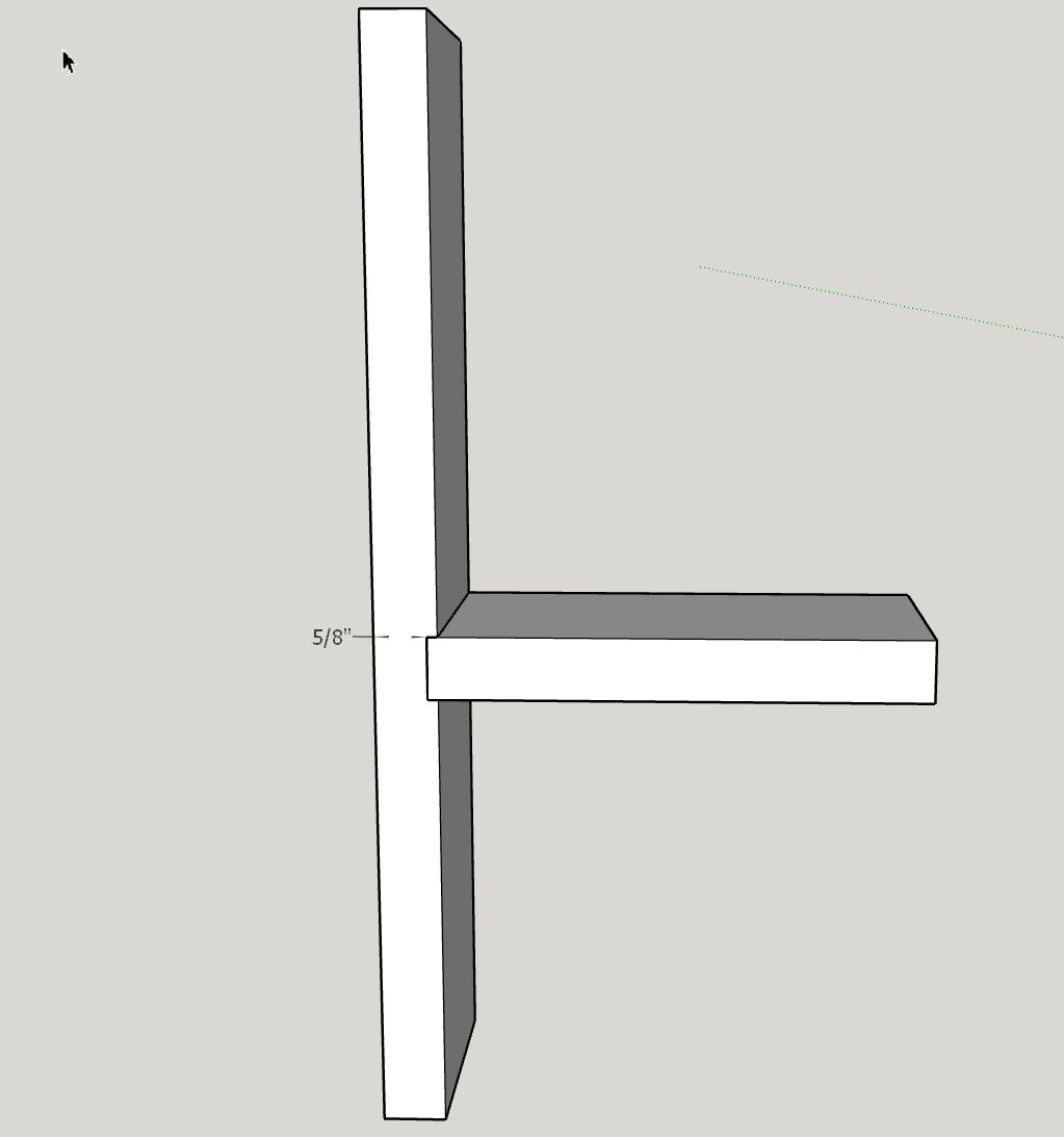

I also wanted to mention a little extra that I have found useful. You don't have to just depend on the pocket hole for all of the joints strength. Like anything else there are many ways to do things. One that I have posted here before at some point is a joint like this:
The dado needs to be shallow so you still have room for the pocket screws but you gain the dado which supports more weight and keeps any twisting motion of the horizontal member to a minimum.
