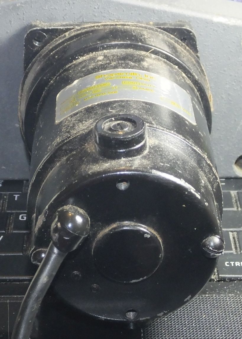

Maybe this will help?
feed motor.jpg (209.06 KiB) Viewed 9290 times

I examined my motor and I see no obvious markings that would define the intended physical relationship of the motor parts.
