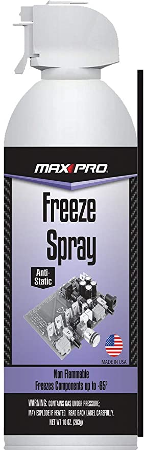

I think you’ve just added a new tool to our arsenal!
I’ve occasionally used freeze spray to diagnose intermittent electronic components, but it never occurred to me to try it on balky fasteners. But it makes stuff real cold, real fast, and is very localized when you plug the little straw into the nozzle. So I’m thinking it would outperform even a torch for creating differential material expansion. Perfect for shrinking a screw, and not whatever it’s stuck in.
The stuff we used at work looked something like the product below.
For a double thermal whammy, I suppose that you could heat the entire assembly, and then hit the screw with freeze spray.

It's been close to 100 where I am and this did the trick for me. Thought about using a hair dryer instead of the heat gun, but the ambient temperature seemed to enough.
