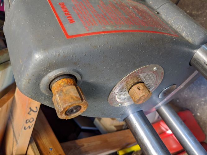

Starting small.
Could anyone tell me how I would get the rust off of these? Steel brush?
- resize.jpg (323.88 KiB) Viewed 66498 times
Re: New owner, want to restore
Well ghouliegirl you could replace them with new ones.
https://www.shopsmith.com/ownersite/cat ... r_hubs.htm
They are not overly expensive. Or even used ones off of eBay. However if you're wishing to keep as much of you Mark V as original as possible I'd recommend removing them and cleaning them individually. Maybe use some rust dissolver gel like this.
https://www.amazon.com/gp/product/B0007 ... UTF8&psc=1
Brush it on with a bush, let it sit then wipe it off.
I think a wire brush could misinform them to a degree so I'd use a softer approach.
Guys if i'm wrong chime in.
Take them off the spindles. They're each attached with your 5/32" set screws. A 5/32" allen wrench is your Shopsmith toolbox. Then soak them in Evapo-Rust. Definitely the best way to remove rust for small items.
