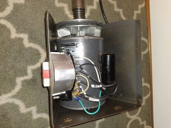

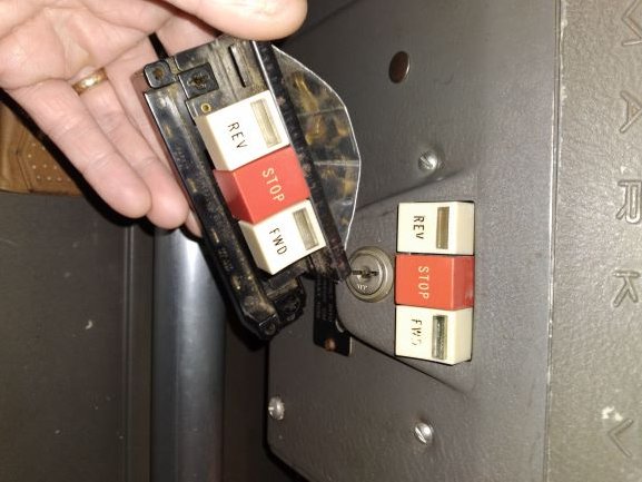

So I have been cleaning up the Mark VII over the last few weeks and it went pretty well. It's all back together and it starts and runs better than I ever remember. I was looking through one of my dad's old tool boxes and found another complete switch. He must have been saving it, as it is in much better condition than the one in the machine. Still, I decided to better repair the old switch and run it as long as it lasts. I even found the replacement light bulbs at HD (just like JPG said in another post I read). It now works properly including power to L1 and L2, forward and reverse, with key safety. I also replaced the old stiff power cord. I decided not to install the vacuum for now.

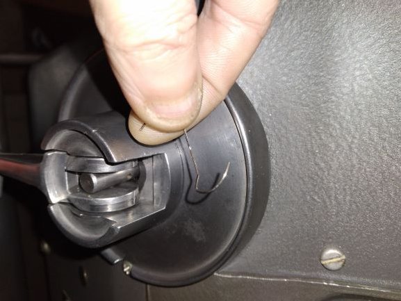

1. does anyone know how the little spring goes back into the headstock pinion drive crank handle? See picture.

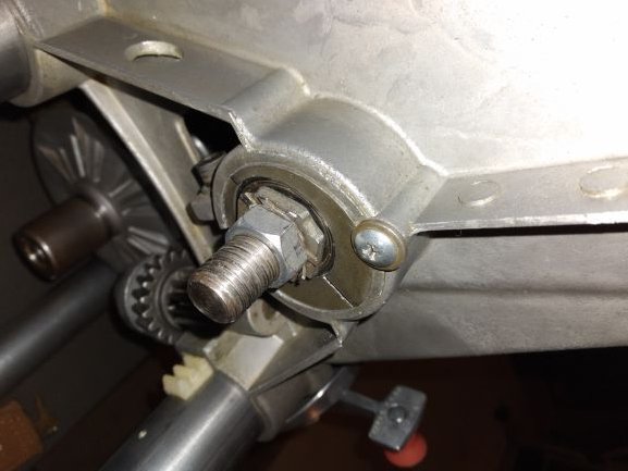

2. I am not sure the square nut belongs on the shaft next to the eccentric? Does anyone else have this square nut?
3. how tight is the nut on the eccentric supposed to be? I know it is just tightening against the circlip on the opposite side of the eccentric so I imagine it should not be torqued to much.

Oh! You HAVE the little spring! IIRC the small end goes into the small hole in the shaft and the large radius end lays against a similarly shaped surface. I have never understood the reason for that spring.(mine originally did not have it)
The idler shaft need only be snugged to eliminate play. The square thingie is furrrun. The lock tabs prevent the loosely tightened nut from backing out.

Yes, I have the spring! :) But I would need a picture to figure out how to get it back in there. I am not worried about it. I think it is supposed to stop the crank from rattling. Thanks for trying to explain it to me.

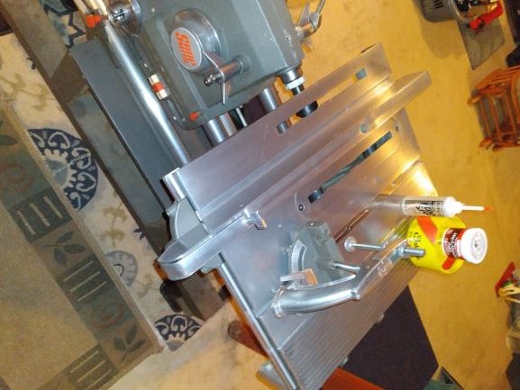

Also, my Mark VII does not have the casters, and I really want them. Do you think it's possible to retrofit a set of 510 casters if I fabricate the part below? Are the cams, rods, foot pedals, etc. the same? I see several sets of 510 casters available on ebay.

The caster assembly is an entirely different design that is incorporated into the base. Item "7" above tends to break. There is more than one design version. I dislike "5" above.
furrun is hillbilly speak fer foreign.
I think you can improve upon both 6 and 7.
IIRC the stem length on "12" is shorter.
Then there is that weird foot pedal.
Not sure installing that spring is possible with the assembly 'assembled'.

Furrun, Hillbilly, funny. I am pretty sure the square nut was added so the front nut could be used as a jam nut and tighten against it. The inside piece of that special washer that keeps that nut from backing off, the part that fits into the keyway is gone. It probably kept loosening up and that was a quick fix.
