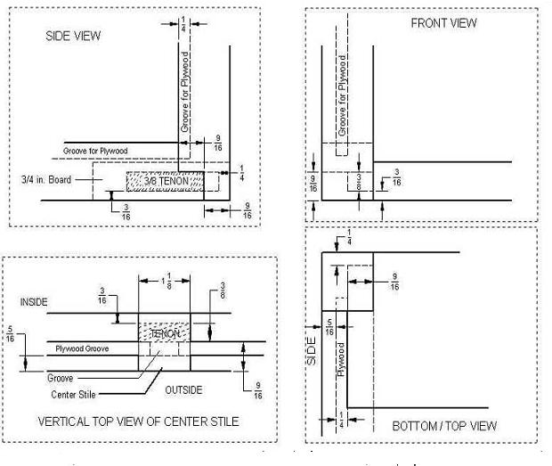

Today in making my latest project I have designed several mortises and grooves at different depths to give interlocking joints. When one mortise edge was off by 1/64" it was a very simple thing to fix with the adjustable stop collar.
Just for kicks, I have included a sketch of the joints I designed for this project. Yes, it is a little overkill, but very do-able with the OPR. Frankly, I would have had one hell of a time with one of my tables.

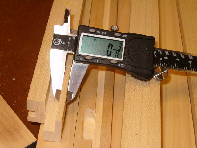

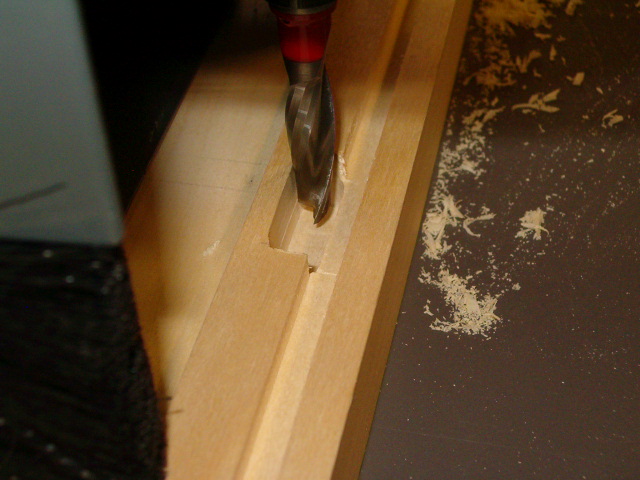

In the first Photo, the caliper shows a 3/8" stopped mortise that is exactly 3/16" from the edge, to allow a good fit with a 3/4" board. This photo also shows a 3/8" stopped mortise (only 3/4" long) that lays perfectly against a 1/4" groove. That stopped 3/8" mortise is 9/16" deep, while the 1/4" groove is 1/4" deep. Setting a fence on a router table to do this would take a few test pieces.
[ATTACH]2274[/ATTACH]
[ATTACH]2275[/ATTACH]
[ATTACH]2276[/ATTACH]
