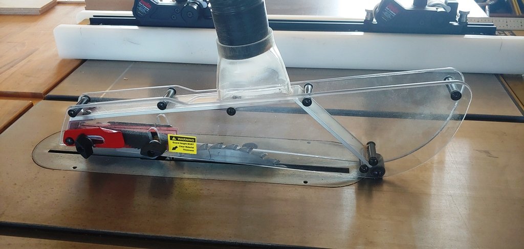

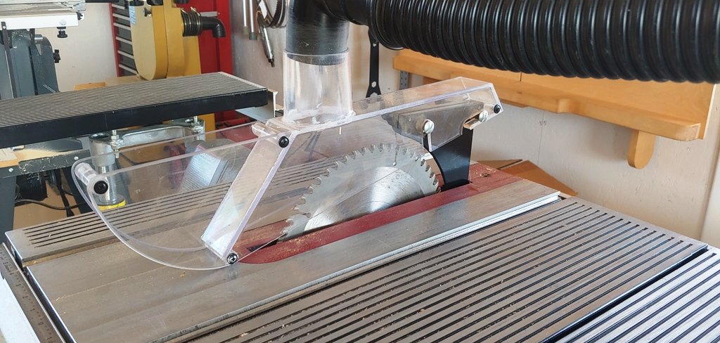

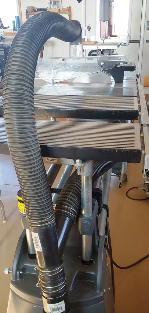

stew wrote: Sun Nov 29, 2020 9:23 pm Hey John any chance on getting a picture of your Shark Guard set up on the Shopsmith? Does it cause any problems if you move the SS or do you always keep your SS in the same spot. My shop is small so I am always moving mine.
Thanks!
Here are some better pictures of the SS Shark Guard. As I said this guard was made in 2007 and was one of the first SS model he sold. Material and workmanship have much improved over the years. The last picture is the Shark Guard on my PM2000 table saw. It was bought somewhere around 2012 or 13. There is a big difference in the material and workmanship. I have not looked lately but I am sure there have been more changes in the last 7 or 8 years.

That dust collection system appears to be all that anyone could ask for. I see not a single sign of saw dust in that shop. :rolleyes: Either that or you have one of the best janitors available.
Posts: 6584
Re: New Shopsmith DC-6000 Dust Collector
dusty wrote: Mon Nov 30, 2020 3:14 pm That dust collection system appears to be all that anyone could ask for. I see not a single sign of saw dust in that shop. :rolleyes: Either that or you have one of the best janitors available.
A little bit of both. :D However, the Shark Guards are amazing. They get 98% of the above table dust.
