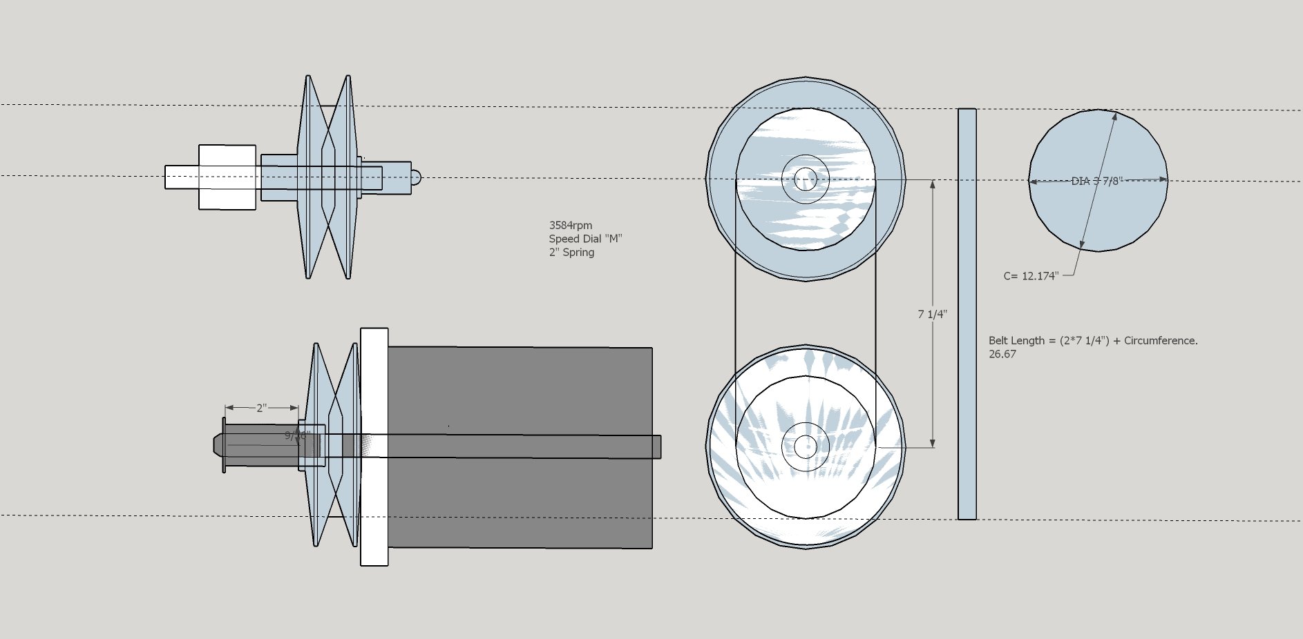

Re: Mark VII Low Speed Too Fast
Sheaves at 3340 RPM.jpg (128.46 KiB) Viewed 2154 times
I'd be real interested in hearing from others about how these dimensions compare to other machines.
PS: This drawing is specific to a Mark V and NOT necessarily applicable to a Mark VII

dusty wrote: Fri Oct 01, 2021 3:26 pm I'd be real interested in hearing from others about how these dimensions compare to other machines.
I can grab a few dimensions for you, my headstock is apart. I am pretty sure the center to center on mine is 9 1/8", but I read in another post where JPG measured 9 3/8", so I will remeasure.
miken wrote: Fri Oct 01, 2021 3:54 pm
Mike -
Do you also have a Mark 5/V. The Mark VII may very well be different.
Confusion between models is the very reason that I wish this forum was more strategically divided.
