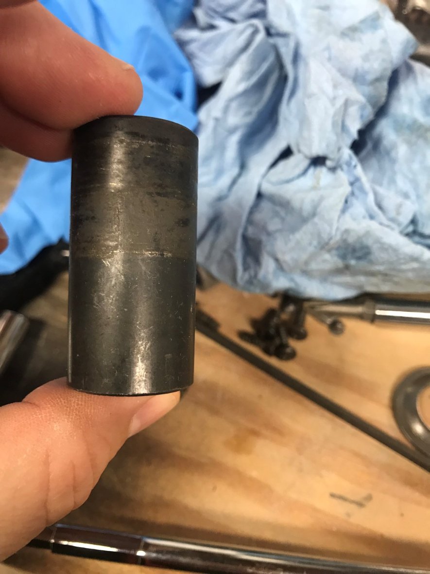

JPG wrote: Wed Dec 15, 2021 11:05 pm That "bushing" has an internal key groove that a woodruff key on the quill feed shaft rides in. The "bushing" slides in/out and when it presses against the domed washer which locks the quill position. The key causes the "bushing" to rotate with the quill feed shaft. A wave washer presses against the outer end of the "bushing" when the quill lock wingnut is tightened. The wave washer allows semi tightening of the quill position.
I'm with ya JPG... Now that I have it apart it's all starting to make since. That video I found was a huge help too.

HopefulSSer wrote: Thu Dec 16, 2021 10:16 am If you think it's pine sap try turpentine
I tried WD-40 HopefullSSer... Looks like it took it off. But it looks like it's already done its damage. What do you guys think. Should I hit it with some 500 or 1000 grit sandpaper?

Was that 'stuff' on the inside bore of that part too? I assume it has to be in the headstock bore... Sounds like you're going to find it in many places.
Any abrasive may remove the black oxide coating on parts like this one that have it, and it is there for corrosion control. I'd only remove the coating as a last resort. Scotch Brite pads with the WD-40 or other solvent is worth a try. If you've removed enough of the adhesive that the part works you can use JPW to reduce friction and it may clean it up a little more. I usually wax these parts and the headstock bores, but only if I have it apart for some other reason. I do use fine abrasives on parts, just try to avoid it on black oxide.
IIIWM I'd want a solvent that works and would let me soak small parts. If you're happy with WD-40 you can get a gallon at many retailers. At least you can if you live in the country. Tractor Supply and similar carry it around here.

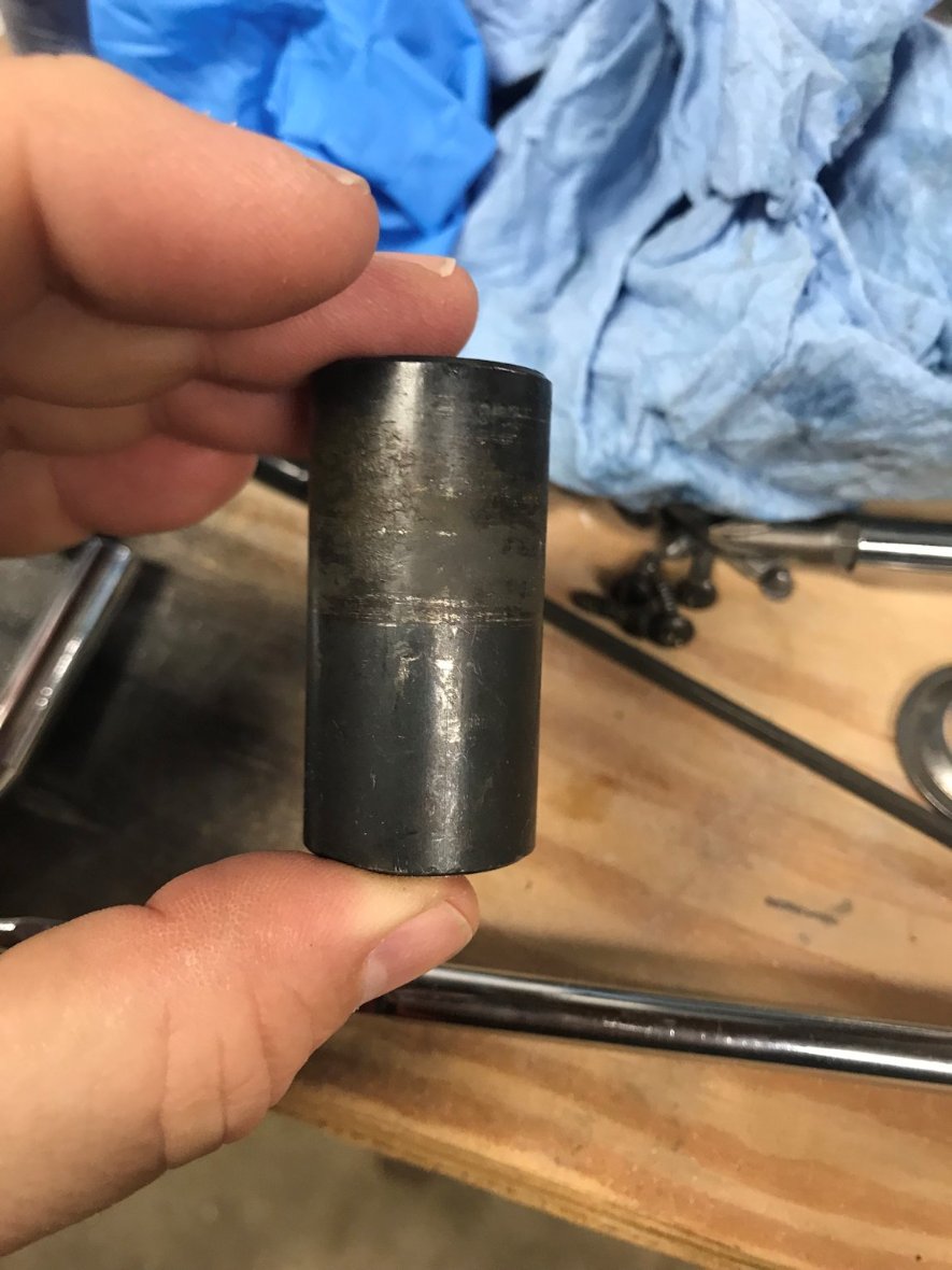

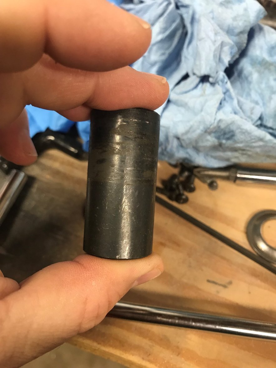

Well David I was looking at this part. If you refer to the picture I posted that shows it in the headstock half of it isn't even in the bore. I'm thinking I can leave it as is and just flip it so that damaged portion is the portion between the domed washer and the headstock bore. Then all I have to do is turn my attention to the headstock bore and see if I can get that cleaned up... I have a battery post cleaner that has a wire brush for the inside of the battery terminal. I thought about hitting it with some WD-40, let is soak for a little while and then hit it with the brush. Do you foresee me creating any issues doing that?

I wouldn't use a battery post cleaner brush since it is a heavier wire and could scratch the hole. Something that is okay for battery cable ends but not for holes that you want parts to be able to move in. I have used very fine foamed backed sanding pads for cleaning up holes in Model 10 headstocks but those are cast iron and not aluminum like the Mark V headstock castings. A scotchbrite pad may be less abrasive. I roll up the sanding pad and insert onto the hole to rotate it around. This is after cleaning out any "sticky" residues in the holes. The idea is to polish the hole to be clean and smooth. For yours clean out any sticky residue first then decide if it still needs polishing. This would be true for your entire Mark V 510 since the "stuff" seems to be everywhere.
When reinstalling the pinion shaft make sure the end of the quill return spring is completely engaged on the pin on the shaft. Install with the indicator mark on spring housing facing up in line with the set screw.

Okay... So it was like 52 degrees yesterday and stormed into the night. Tornado's in Minnesota and rain. We had it all. Then it flash froze and everything is coated in a sheet of ice. While walking to my truck this morning (after the Mark 7 had been delivered) I slipped ass over elbows on the ice and hurt myself. LOL... Now I'm hobbling around with the worst pain in my back. However I have been able to force my way through the pain for the most part and I had used WD-40 and soaked the bore for a few hours. I used those cheap light blue paper shop towels and gave the bore a good rub. Then I put the bushing or sleeve back in the bore and it moves freely so I think I'm ready to begin waxing and reassembly. Provided I can stand my back pain long enough to do so.
