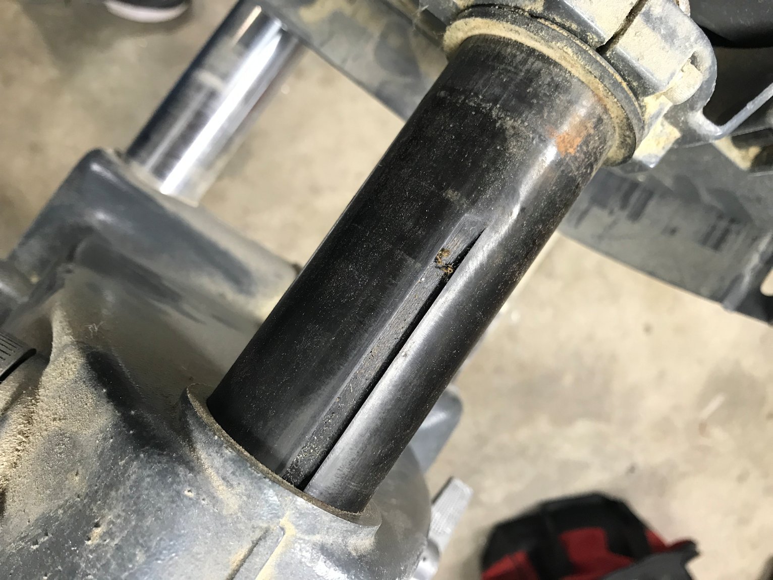

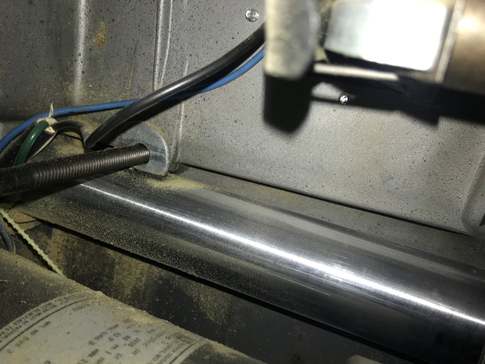

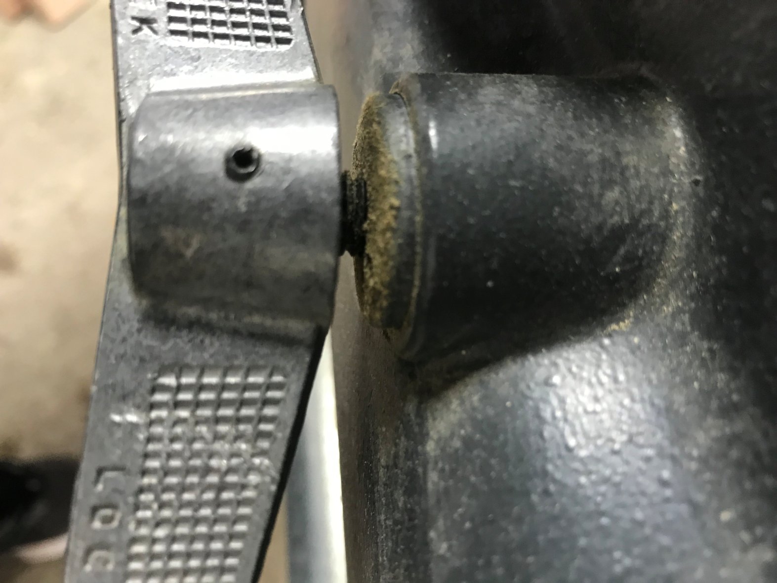

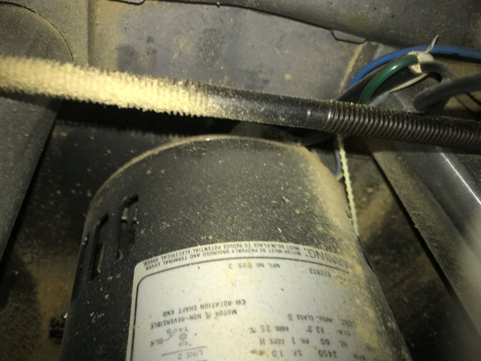

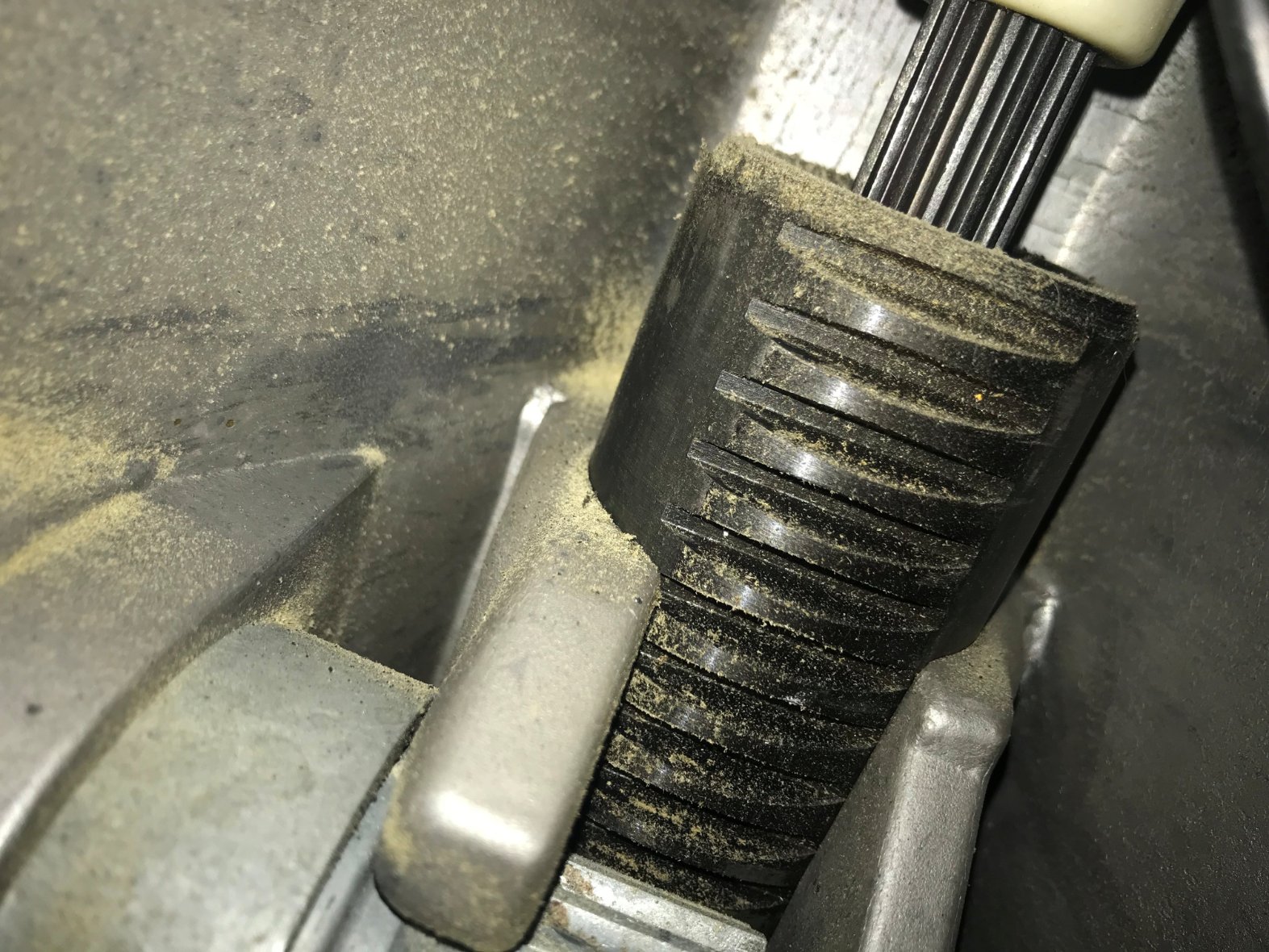

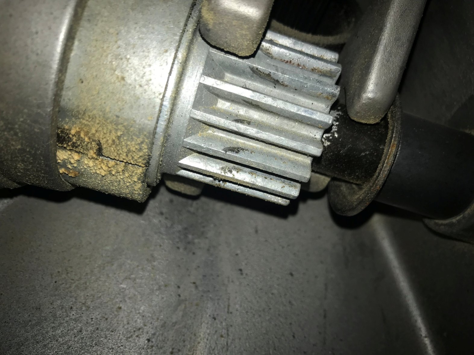

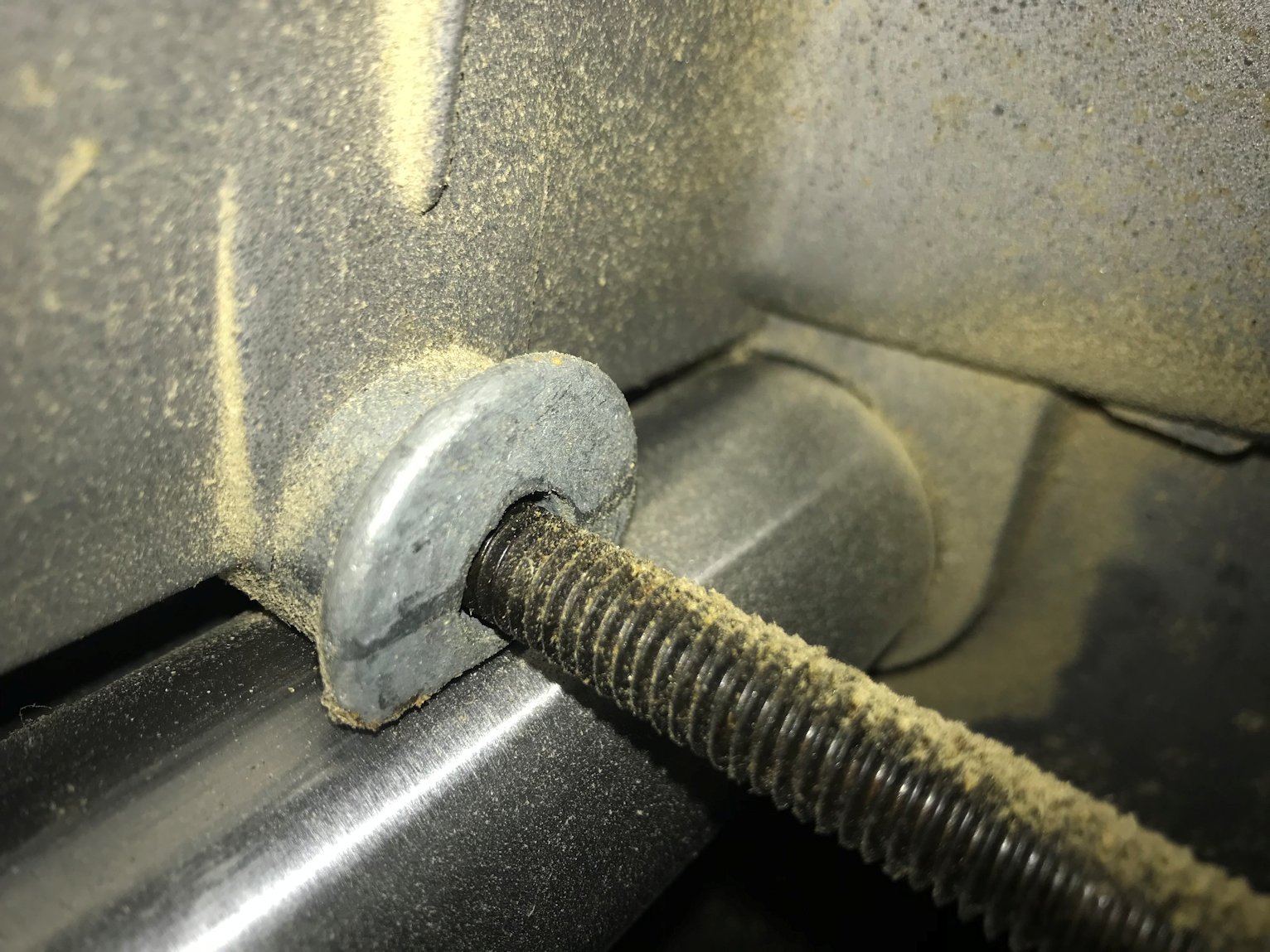

Thanks Beeg. I've had some time to inspect it now that I've been home and nothing looks overly dusty. Not like I imagined it would be. Here's some pix.
That quill is stiff and I mean stiff and that headstock lock is hard to turn too. I turned the lock lever until the Wedge Lock started coming out with it. I tried tapping it with my hand and it would not budge. I tried a gentle tape with a deadblow hammer and still nothing. I'm getting the feeling I'm going to have to tear this down and really really clean it.
I guess it's dirtier than I thought after I saw the pix.

No pix of the rear headstock wedge lock. I think it is jammed.
Overall it kooks pretty clean considering. I think it will clean up nicely!
Is that domed washer stuck on the quill feed shaft?(and the sleeve etc).

Try pushing or tapping on the other end of that wedge lock shaft, on the back side of the headstock. Mine is not releasing correctly and I sometimes have to press on it to get the lock to release.KCollins wrote: Sun Dec 12, 2021 6:20 pm
…and that headstock lock is hard to turn too. I turned the lock lever until the Wedge Lock started coming out with it. I tried tapping it with my hand and it would not budge. I tried a gentle tape with a deadblow hammer and still nothing. I'm getting the feeling I'm going to have to tear this down and really really clean it.

Why make it so hard to clean the back end of the quill, why not just pull the quill all the way out where you can easily clean and wax the entire thing? You have to be careful not to let the quill extension lever spring back as that will probably cause the spring to disengage. I use a small bungee cord wrapped around the quill extension handle and the closest way tube to hold it in the extended position. You only need to loosen the set screw located on the top of the headstock, and then extend the quill until it disengages; you can then just slide it out. While the quill is out you can clean the pinion gear that engages and extends the quill.beeg wrote: Sun Dec 12, 2021 5:08 pm Unplug the headstock.

While the quill is out you can also clean and wax the headstock bore for the quill. I use the depth stop lock to keep the quill feed handle from returning and maintain spring tension while the quill is out. Turn the dial to 4-1/4" and lock it to prevent return.Majones1 wrote: Mon Dec 13, 2021 1:43 am Why make it so hard to clean the back end of the quill, why not just pull the quill all the way out where you can easily clean and wax the entire thing? You have to be careful not to let the quill extension lever spring back as that will probably cause the spring to disengage. I use a small bungee cord wrapped around the quill extension handle and the closest way tube to hold it in the extended position. You only need to loosen the set screw located on the top of the headstock, and then extend the quill until it disengages; you can then just slide it out. While the quill is out you can clean the pinion gear that engages and extends the quill.

Is this the rear headstock wedge lock JPG? And I am not seeing a domed washer on the quill. Where is that located?JPG wrote: Sun Dec 12, 2021 10:34 pm No pix of the rear headstock wedge lock. I think it is jammed.
