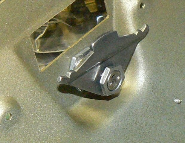

Did the lock come from the same source and did it include the MVII stuff attached?
Re: Mark VII a start and a long ways to go..
Posted: Wed Sep 07, 2022 7:12 pm
by Mike
JPG wrote: Tue Sep 06, 2022 9:50 pm Did the lock come from the same source and did it include the MVII stuff attached?
Hi JPG- Everything in and everything from same source in that pic, not sure what you are referring to “ did it include the MVII stuff attached?”
Posted: Wed Sep 07, 2022 11:13 pm
by JPG
The parts that attach to the lock that provide interlocking of the switch between fwd and rev.
MVII lock attachments.jpg (65.98 KiB) Viewed 2192 times
Posted: Thu Sep 08, 2022 4:47 pm
by Mike
Yes I missed that and thank you for bringing it up. I’ll ask the guy if he has that portion.
