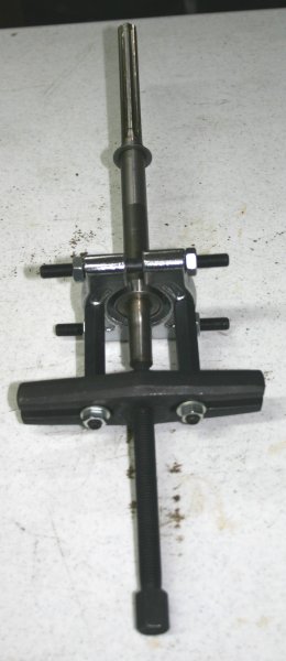

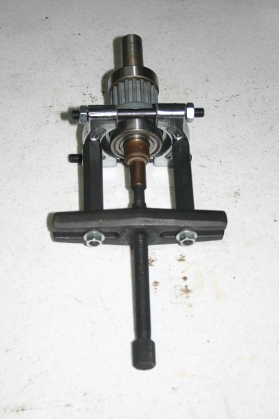

While at HF I bit the bullet and bought Bill's Bearing Separator and Puller set. Now I just need to figure out how to use and get those bearings out.
Time to get to work. Thanks for all the tips. Etcguy, I'll be using your instructions for the motor (it's definitely the bearings in there). I'll also be pulling the bearings in the drive sleeve and maybe the quill.
Any tips that come to mind, let me know. Thanks.
Glad to here you had success with the impact driver. I almost didn't even mention it figuring you did the task already. The impact driver is one of the best tools I've purchased. jpg's advise will help you master the thing. As your smacking it with the hammer, you keep firm rotational pressure on it (counterclockwise) as if your turning the screw out by hand and it prevents the tools from walking away from you.
Here's a couple pics to give you a visual of the puller at work. It's really easy. If your not clear on it, don't hesitate to bark up. We'll help you out.
[ATTACH]3484[/ATTACH] [ATTACH]3485[/ATTACH]

Thanks for the photos. I may get one of these sometime in lieu of the machine shop work I'd gotten before. One thing I do not readily picture is pressing the bearings on -- especially for a very long shaft. Is the same tool capable of this?

nuhobby wrote:mickyd,
thanks,
This puller is on sale until March 23. Yes, I had used the same puller to install bearings on the Drive Sleeve. It has extensions that you put together to extend its reach. I had to make a button ( used several body washers for a while) for the quill shaft end of the Drive Sleeve for the puller's screw to work againest. I center punch the center of any solid shaft for the puller's screw tit so it would stay in the center of the shaft. I use the flat side of the plates againest the bearing when installing them. I use a 5/8" ID X 6" pipe to install the quill bearings.
thanks,
The only ShopSmith V bearing that you can't readily install with the bearing separator kit as purchased is the quill bearing BUT.....it's easy to do without it. If you put the quill in the freezer for a couple hours and the bearing in a warm oven (~150*), the bearing will slide on with little to no force. I installed mine last night and the bearing actually slide on right up to the shoulder with only hand pressure. You have to push it on QUICKLY. The instant after it hit the shoulder, it wouldn't move. Just to make sure it was on all the way, I put the shaft bearing against the jaws on my machinist vise and tunked the opposite end of the shaft with my nylon hammer.
