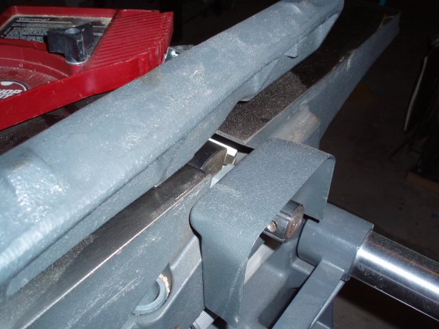

dlbristol wrote:Re installing the shield is not easy to do. I messed about for quite a while before getting it right. On the newer planers, there is not a hole on left side of either infeed or outfeed, so you can't install the shield. Maybe there is another fix.
I don't have a late model jointer (early 1990's) but it does not have a hole to facilitate blade guard installation to the rear of the fence. That is too bad. I have never given much thought to how much blade exposure there actually is.
I believe this will probably lead to my using other methods when cutting rabbets.

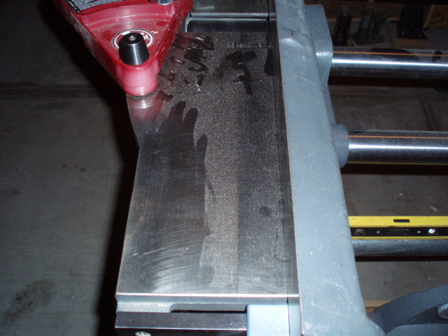

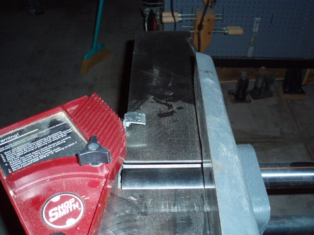

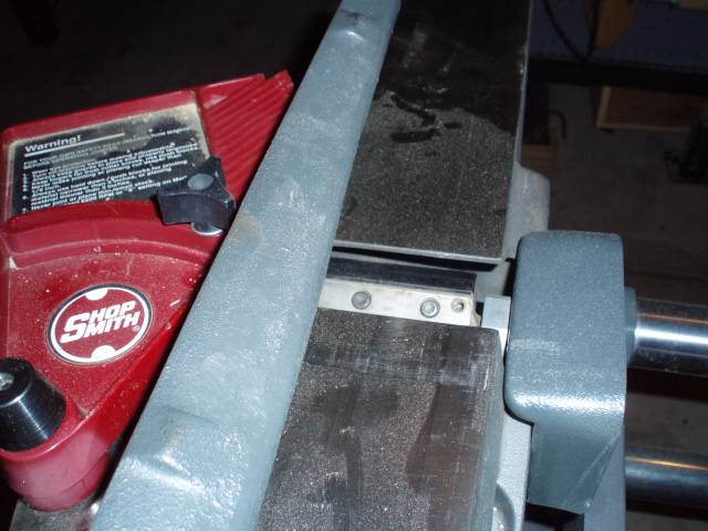

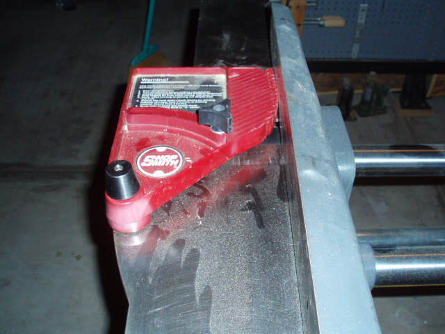

Joiner Blade Guard
For attaching to any Shopsmith joiner, Shopsmith sells the lastest cutter header guard separate that you have to drill the fence and attach this guard. I highly recommend installing this guard on the fence of any joiner that will be used to form precision edge rabbets and tongues.
513948 Guard & Label
514040 Pan Head Screw 2 needed
For joiners with serial number less than 70,000, Shopsmith offers the following that includes the cutter head guard:
555077 Joiner Dust Chute Retro-fit Kit

JPG40504 wrote:Looking at the exploded view, NOT MUCH.
The exploded view lies.
I moved my fence all the way to the other side and the guard still covered the knives.
billmayo wrote:For attaching to any Shopsmith joiner, Shopsmith sells the lastest cutter header guard separate that you have to drill the fence and attach this guard. I highly recommend installing this guard on the fence of any joiner that will be used to form precision edge rabbets and tongues.
Bill;
Without a picture, I am not sure whether I have this guard or not. I have posted pictures of my jointer. Can you tell from these whether or not I am equipped with the Guard 513948?
You DON'T have it Dusty. When I get time later I'll post a pic of mine, which I belive is older than yours.
