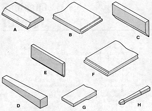

Edge jointing and face jointing have both been mentioned several times, but to my memory - there has been only a few notes or questions about the other capabilities of the machine.
The jointer can be used to make chamfers, tenons, bevels, tapers, edge and end rabbets and exaggerated cut depths. [ATTACH]3539[/ATTACH]
With all of these capabilities, the jointer may be one of the most under-used machines in our shops.

- F6-02LG.jpg (24.97 KiB) Viewed 6251 times
