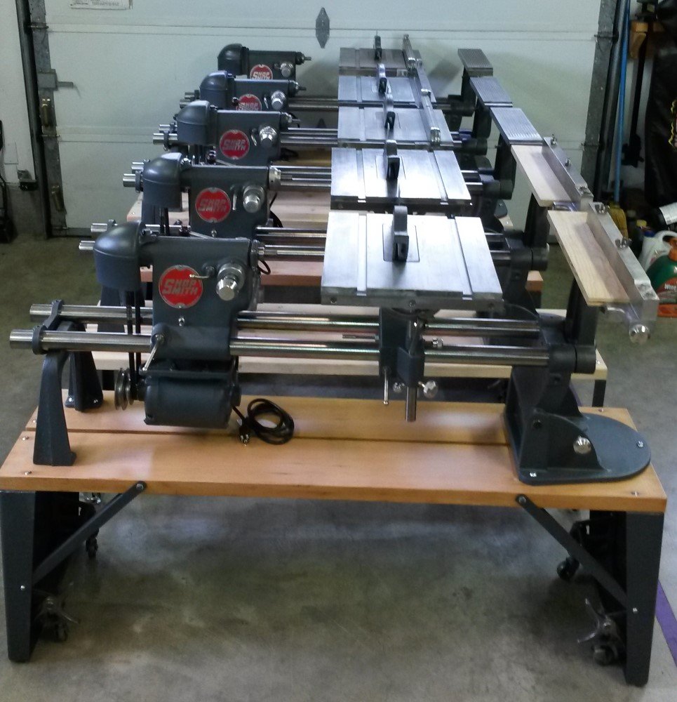

WARNING: Restoring Shopsmith can be habit forming. Since I bought my first Shopsmith Model 10ER I have restored 23 additional Model 10's and currently have 2 more here to restore plus a Mark 2, a Model 4E Jointer and other accessories. The picture below is a prime example of how habit forming it can be.
_
4708-8865-R55582-R57376-R64000 full.jpg (154.69 KiB) Viewed 4683 times
The above picture was taken in 2016 when I happened to have five Model 10's restored before some were sold. The one in back is the first Model 10 I restored and still have. I kept the one in front for a while and the other 3 were sold soon after the picture was taken.

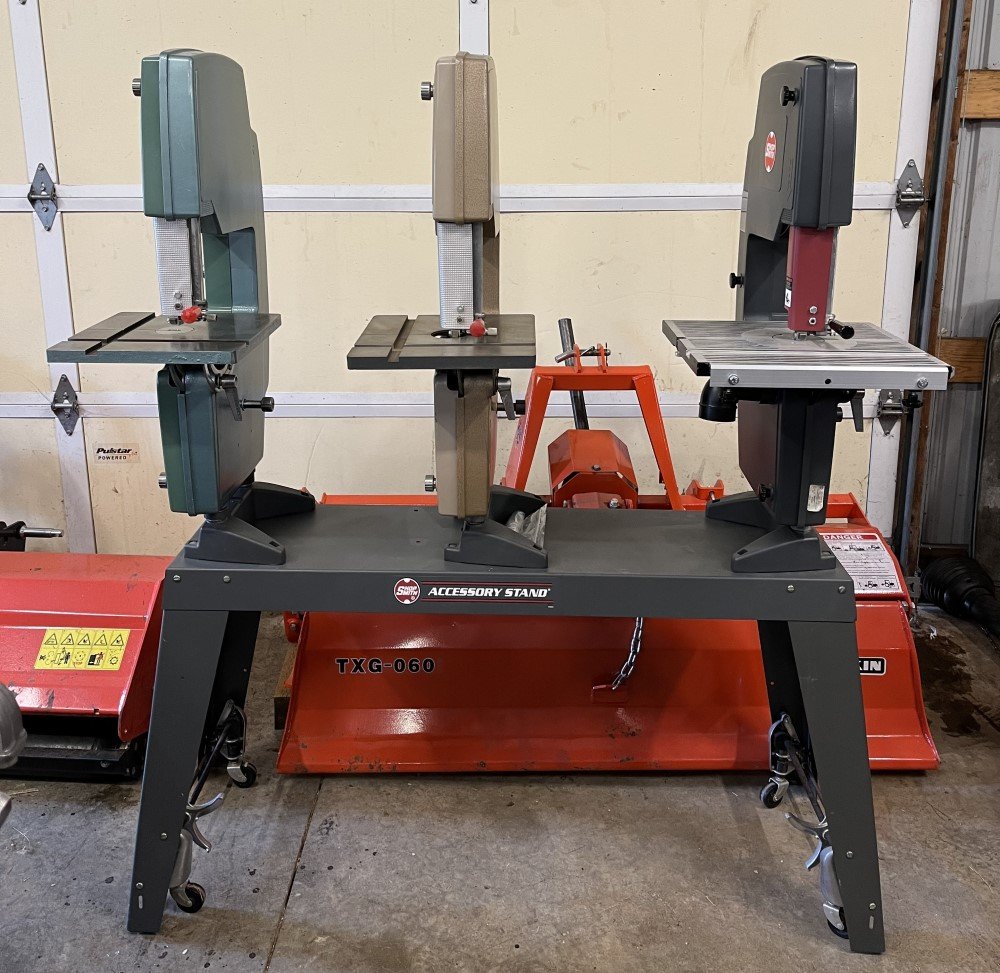

Now having said that, I do have a large collection of Magna/Shopsmith tools I have kept and the list below does not include everything I have. For example I have more than one of some SPT's. The picture below shows three of the four Bandsaws I have. Shown is a Greenie, a Goldie and an upgraded 1998 plus I have a 2006 not shown.

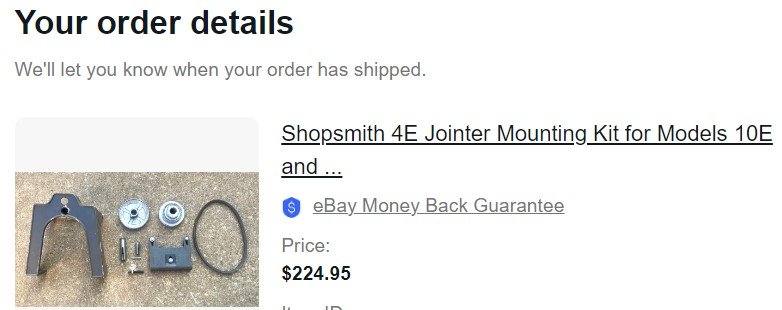

Oh and you just cost me $225 today, after seeing a pic of your 10ER with a Jointer I had to have one so found the complete mounting kit on Ebay today, just need to find a good 4E planer now.....I read your post on the jointer mounting subject and would have prefered to go with option #3, an adapter mount from Skip but he lost the supplier making them for him and didn't want to pass up on this rare mount :(

Not all Model 10's had the Model 4E Jointer added to them as some owners used the Model 620 Jointer instead.
Besides the Magna Model 4E 4" Jointer made specifically for the Model 10's the Magna Model 620 4" Jointer with Mounting Posts to go on Mark 5's also still had the mounting holes for the Jointer Mounting Kit you purchased. The Magna Model 4E 4" Jointer was, more or less, discontinued and the Magna Model 620 replaced it with a change only to the Base/Outfeed Table adding the Mounting Posts for attaching to the Mark 5 and the color from gray to green. The Model 10 Jointer Mounting Kit was still available for some time after the Model 10ER was discontinued when the Mark 5 replaced it. This and the holes still in the Model 620 4" Jointer for the Jointer Mounting Kit allowed Model 10E and 10ER owners to add the 4" Jointer to their tool. When the second Power Mount Adapter Kit (item 11 920) for the Model 10's came out adding the "B" Adapter and the longer Jointer Mounting Tubes the Model 10 (Headrest) Jointer Mounting Kit was discontinued. When the Magna Model 620C jointer replaced the 620 it no longer had the holes for the Model 10 Jointer Mounting Kit.
