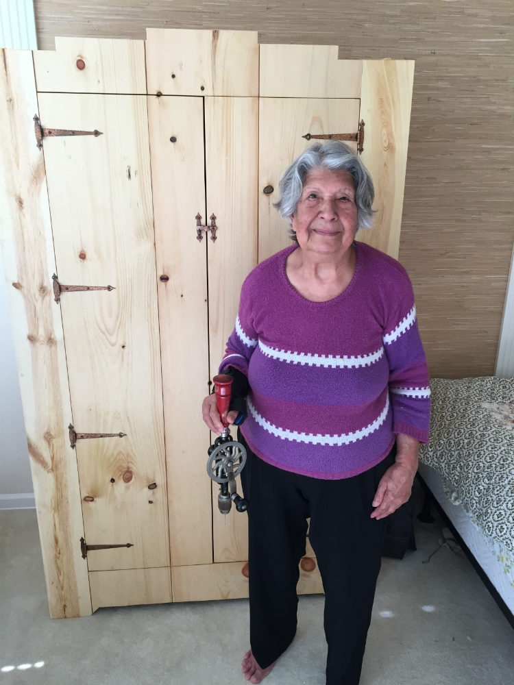

nuhobby wrote:Almost done! For Mother's Day, the new wardrobe for Mother-In-law moved up from the shop to her room. It's about 95% finished. Friday night the Mk. 5 whipped up about 65 hole plugs for a finishing effect.
Installing Latch.jpg (126.93 KiB) Viewed 14815 times
Happy woodworking,
Chris

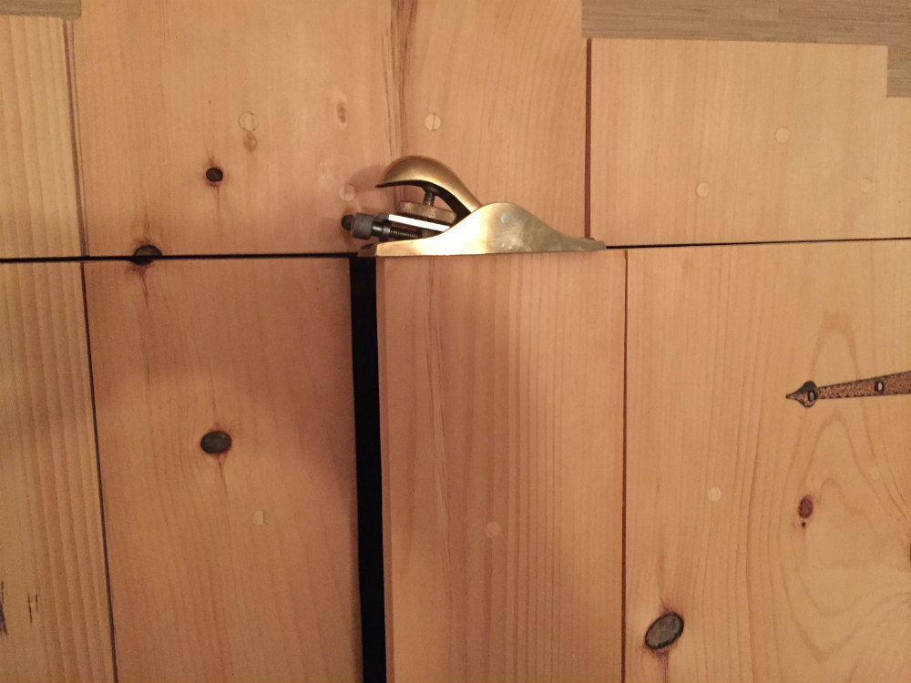

Well, after 6 months, the right-side door was rubbing a bit at the top in this dry indoor environment. Usually things just shrink when it's cold, but this door had evidently more of a compound reaction -- where the width shrank but lengthwise it got in a bit of a bind. No worries, just a bit of shaving needed!
Seasonal Adjustments.jpg (107.62 KiB) Viewed 14815 times
Happy woodworking,
Chris

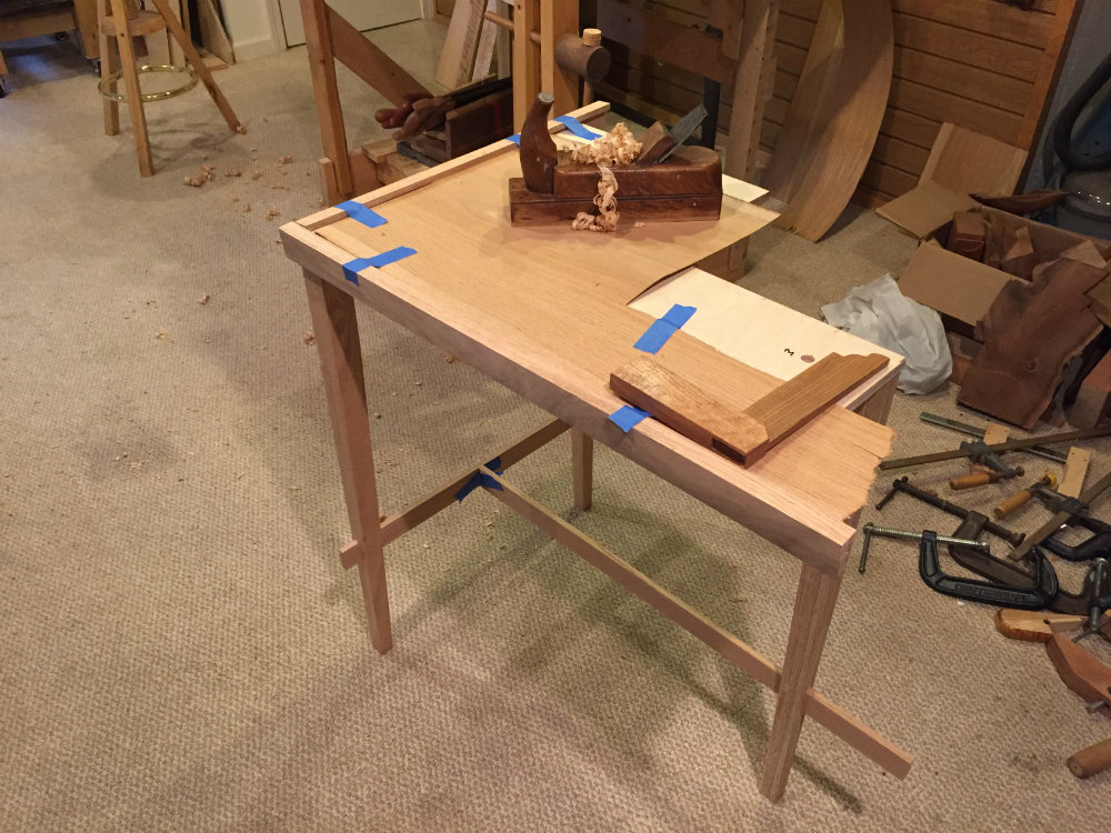

OK... Another parsimonious wood project is now underway... looking to build a 3-legged bedside table!

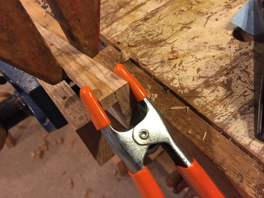

I hate hogging out wood for moldings. Why not build up a molding from smaller pieces cut at the bandsaw?
Resaw into Molding.jpg (133.45 KiB) Viewed 14305 times
Here is the table concept in progress. Recycled plywood top, recycled knock-down fasteners holding the legs to the plywood. Built-up moldings being eyeballed for proportions. Recycled German hand-plane (fastidiously restored using around $5000 of Shopsmith tools in the basement). Yep, I'm money ahead all right!!! ;)
Telescoping Pieces.jpg (192.14 KiB) Viewed 14305 times
Happy woodworking,
Chris

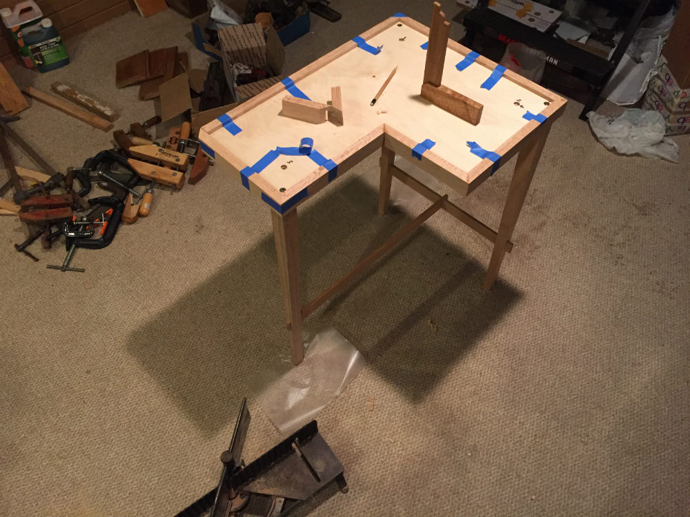

Just a bit more work done this week, better preparing several miter joints. One piece I cut too short... Oh No!!! But I made it into a "happy accident" by putting a "chamfer" rather than a "sharp corner" on the awkward 3rd leg outer corner area...
Table Corner Work.jpg (162.5 KiB) Viewed 14234 times
Chris
