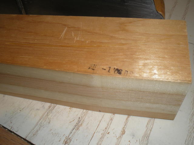

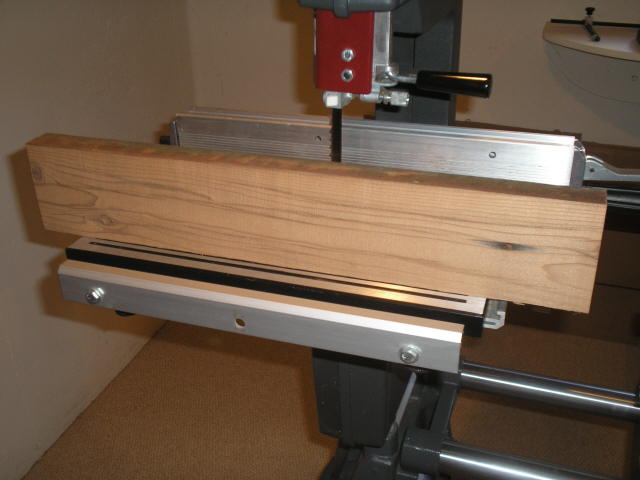

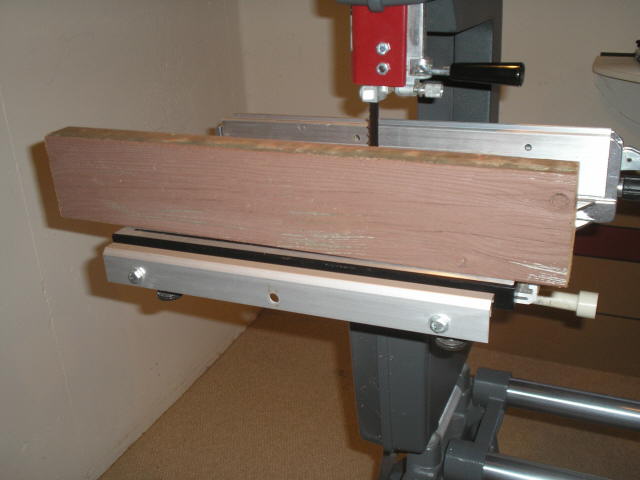

Sometimes around here people will be throwing away pieces of decking wood only 15-25 years old.
I have been gathering this stuff and there are many gems to be found. Just one example using the bandsaw:
- Old Deck Wood.jpg (33.94 KiB) Viewed 44386 times
- Resawn Deck Wood.jpg (37.2 KiB) Viewed 44378 times

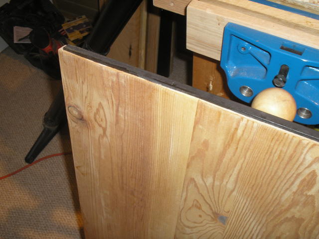

About 25 years ago the fence that went around my back yard was falling down. I ripped it all out and replaced it. A friend of mine (about 50 years my senior, who passed away a few years ago), asked if he could have the old fence, and I told him to come and get it. As it turns out, the only wood that was bad were the 2X4's and posts. He salvaged all of the fence boards by running them through a planer (after pulling all the nails)! They had started out as about 1 1/2 thick clear cedar boards, and after he planed them, he had nice 1" thick (beautiful) clear cedar boards. Why didn't I think of that???nuhobby wrote:Sometimes around here people will be throwing away pieces of decking wood only 15-25 years old.

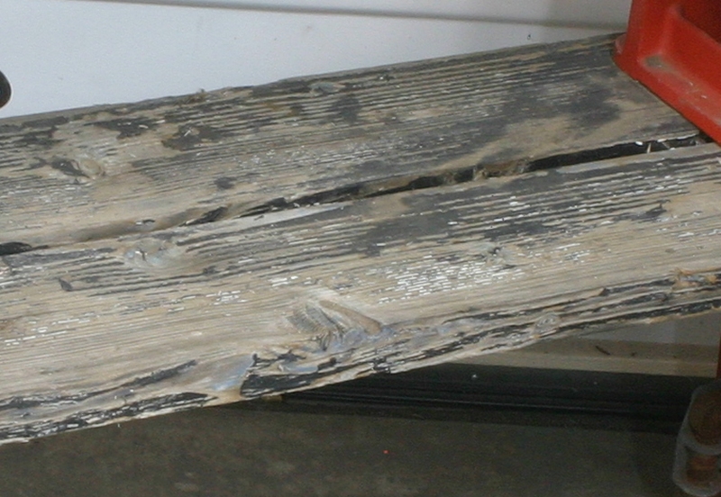

Last summer I found 9 beat-up large pine shelving boards in a shopping-center trash bin. Some of them were almost black from years of warehouse use.
Slowly I am putting together a plan for them....
Here is a "leg" where one lamination luckily shows the 1968 date-stamp of this pine wood (I found that date-stamp more than once in the pile):
[ATTACH]7669[/ATTACH]
Here is where I've put together some crack-free portions of the hardest parts of the pine, and have re-used part of the original metal-strip "breadboard end" stabilizers:
[ATTACH]7670[/ATTACH]

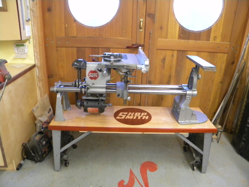

The front doors of my home shop (Canada) are made form recycled pool decking from an above ground pool we 86ed when we bought the house.
Sorry about the distracting object in foreground. It's the only photo I have here(AZ) of the doors.
[ATTACH]7676[/ATTACH]
