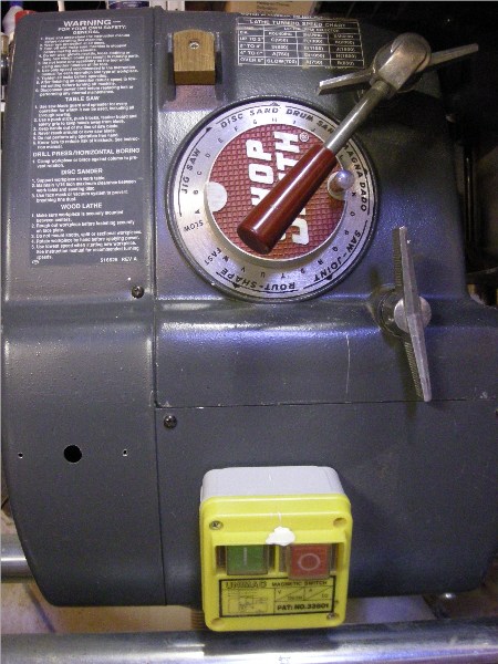

When the switch on my 510 failed some time ago I replaced it with a NVR (No Volt Release) switch. This means that if the power goes down for any reason while I am working the machine will not start up automatically when I restore the power. Two reasons for fitting this:
1 It was easier and quicker to buy the NVR locally than order from SS and wait for delivery
2 I find that the red OFF switch is easier to hit in emergency than the SS one.
A negative result is that I don't have the removable red switch handle to remove when not using the machine, but I don't have any young children any more wandering into my workshop.
I drilled a 1/2" hole into the casing to thread the wires through and fixed the switch with self-tapping screws. The position of the switch makes it much easier to access it. I plugged the hole wher the existing switch was with a piece of wood, screwing it into another piece inside the casing.

Now I would REALLY LIKE a switch like that. Thanks for the info.
I like the idea of the NVR switch feature. I've tripped a breaker a number of times and when coming back from around on the side of house, where the main breaker panel is at, the Mark V is running. This could be a serious accident in the making.
Of course, some simple brain work would do the trick too.:rolleyes:
rayjack wrote:When the switch on my 510 failed some time ago I replaced it with a NVR (No Volt Release) switch. This means that if the power goes down for any reason while I am working the machine will not start up automatically when I restore the power. Two reasons for fitting this:
Great Idea! Where does one get them?

rayjack wrote:I drilled a 1/2" hole into the casing to thread the wires through and fixed the switch with self-tapping screws. The position of the switch makes it much easier to access it. I plugged the hole wher the existing switch was with a piece of wood, screwing it into another piece inside the casing.
I would believe the hole and screw holes in the belt housing looks to be a better place for the switch and looks like it was there at one time. If so, why did you move it to the motor pan which is lower on the headstock and looks harder to find. Did you look at any of the red paddle to turn off type switches which you can hit with your knee or hand in case of quick turn-off?
