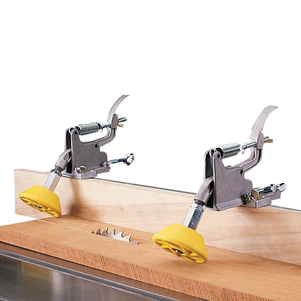

Hi All,
Anyone here have experience using the Board Buddies on a Mark V 520? I used the Rip-Strate for years but don't have it any more and it is not available.
Thanks
Jack
Board Buddies.jpg (156.08 KiB) Viewed 7472 times

Jack, in response to your question about board buddies, I have been using them for years and think they are great. Not too expensive and fairly versatile. I have the ones with the green wheels so I can use them on my bandsaw and router table as well. They roll in both directions so they don't provide the anti-kickback protection of the yellow ones but they do hold the stock down well and have much more versatility. You can purchase the wheels separately from Peachtree Woodworking so you could have the green or orange and the yellow ones and just swap them out when required.
http://www.ptreeusa.com/tablesaw_products.htm#buddies

delong94 wrote:Does anyone have a copy of the manual for rip strate that can easily be sent or posted. Thanks for the earlier posts on mounting it to the fence.
Thanks to the recent activity on this thread, I bought a new-old-stock RipStrate off of eBay. Partly out of curiosity. And partly because I love my Jessem Clear-Cut guides for my router fence, but really didn't want to spend $250 for the table-saw version. My new RipStrate should work just fine, at about a quarter of the price. And it's in pristine condition -- the clamp thumbscrew has never even been installed.
I made a PDF copy of the owner's manual with an iPad camera-scanner app (attached). It ain't perfect, but it was considerably easier than going the flat-bed scanner route. The last page was actually a separate drilling template for the auxiliary fence. It's no longer to scale, but I measured the mounting-hole center-line skew at 2.5 degrees to the fence. Which is interesting, as Jessem uses a 5-degree skew on their Clear-Cut guides.
