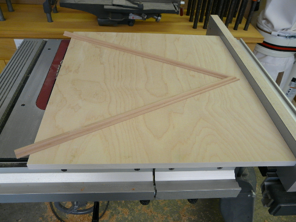

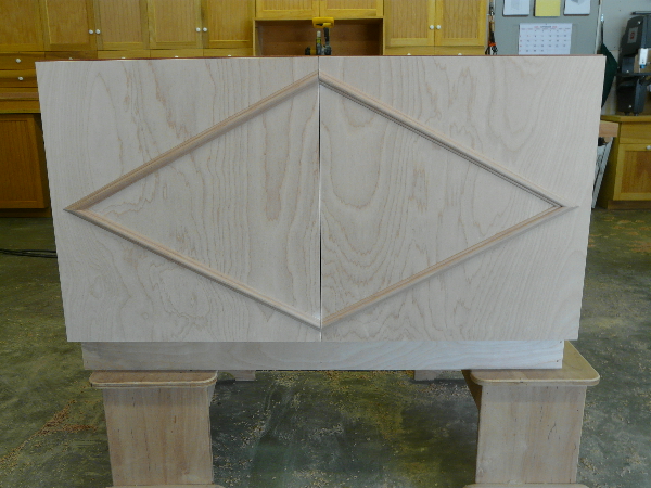

This thread is to cover the technique I used this week to add an applied molding to 3 sets of cabinet doors to form the shape of diamonds. The problem with diamond shapes are the angles are way past 45 degrees. I did not check the angles on these pieces but it doesn't matter.
[ATTACH]5831[/ATTACH]

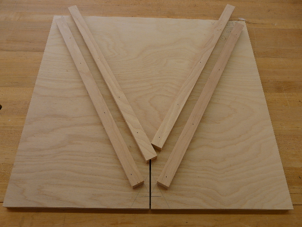

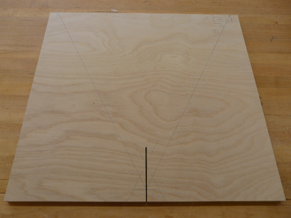

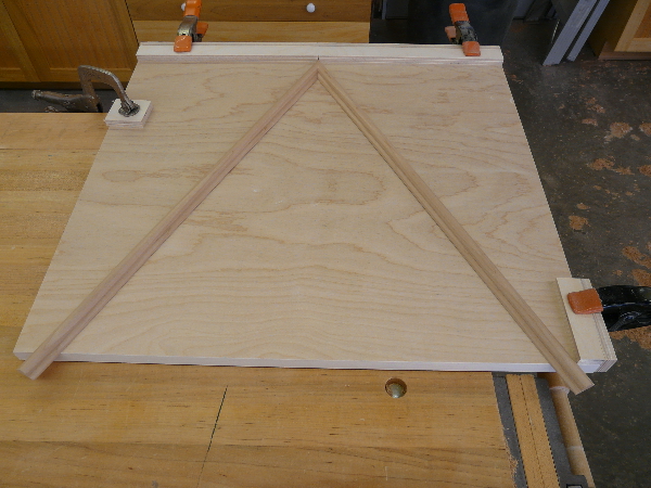

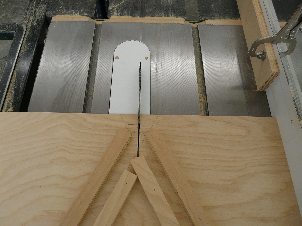

I start out with a scrap piece of plywood the same size as the doors and lay out the pattern. I then made a saw cut in the exact center.
[ATTACH]5832[/ATTACH]

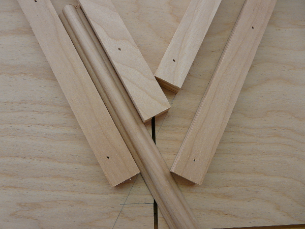

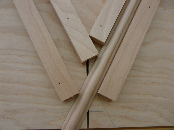

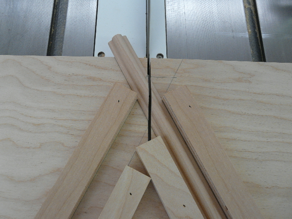

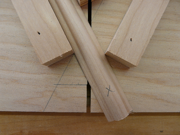

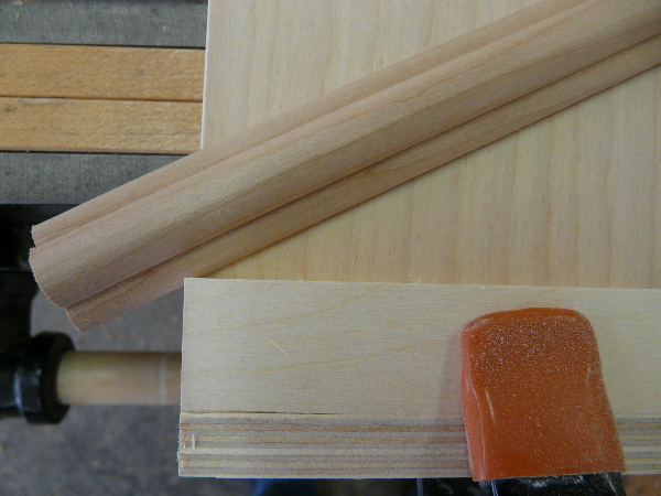

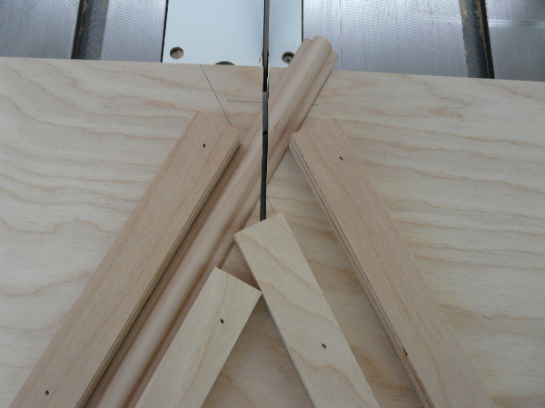

Next I use scrap plywood strips to encase the trim to be cut.
[ATTACH]5833[/ATTACH]
[ATTACH]5834[/ATTACH]
With the design of this jig I can cut lefts and rights.

A word of CAUTION. If you look close you can see a X on the waste side of the trim. I use 2 sided tape on this area to both hold the trim in the jig and to keep the waist piece from being thrown by the saw.

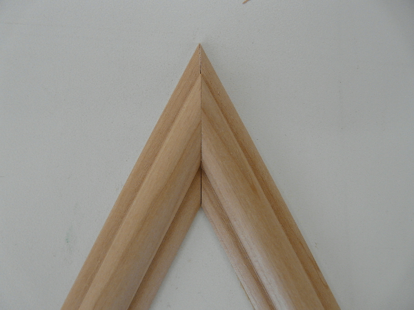

Trial run. With a stop block in place and the trim secured with tape all I should have to do is concentrate on keeping the jig tight to the fence.
[ATTACH]5838[/ATTACH]
[ATTACH]5839[/ATTACH]
[ATTACH]5836[/ATTACH]
This Scotch ATG 2 sided tape gun is popular with picture framers.
[ATTACH]5837[/ATTACH]

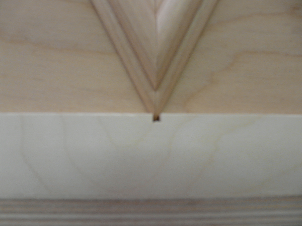

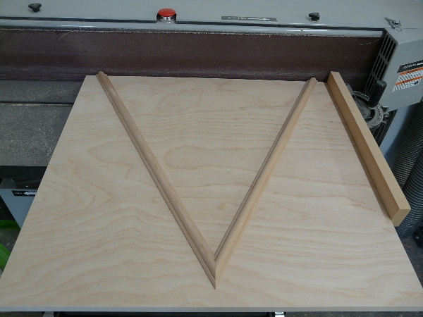

[attach]5840[/attach]
Not bad but I'll change blades to get a better cut.
[attach]5841[/attach]

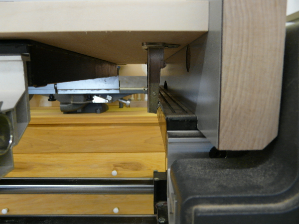

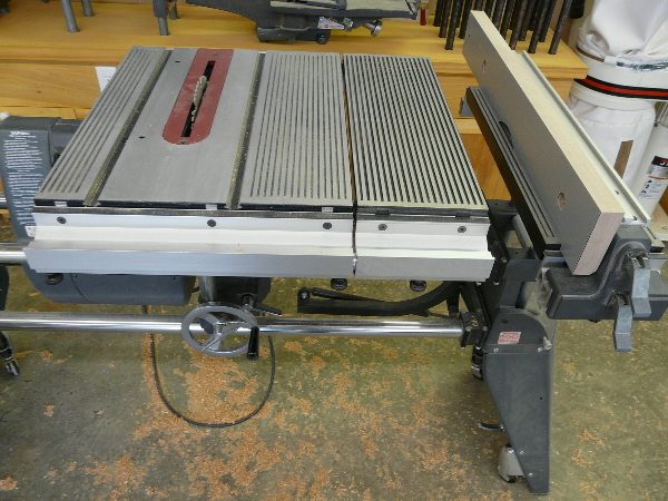

Ok time to bragg on the SS. To use the Minipress I have to insert the Blum hinges before attaching the trim. Even if I take the screws out and remove the hinges the little plastic dowel are proud of the door. I need to be able to cut the trim to within 1/32 of the the door edge with the hinges installed. Only one piece of equipment in the shop that will do that.
[ATTACH]5844[/ATTACH]
[ATTACH]5849[/ATTACH]
I have set the SS up with the extension table set low enought to clear the hinges and with the use of my homade Dado fence I can now trim the trim.
[ATTACH]5850[/ATTACH]
The little scrap pieces shouldn't pose a problem since they can't get bound with the blade but safety glasses are a must and a full face shield is even better.
[ATTACH]5851[/ATTACH]

Our diamond pattern doors installed on the cabinet box.
