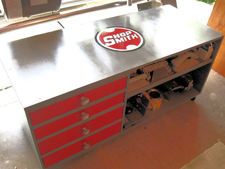

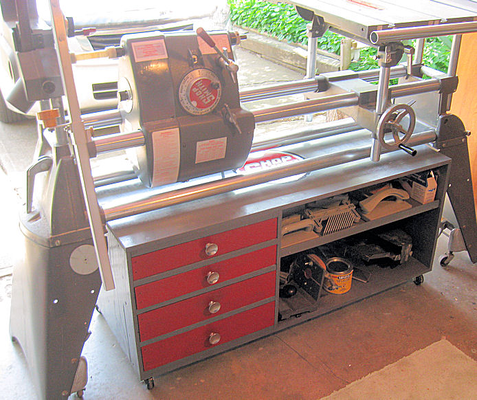

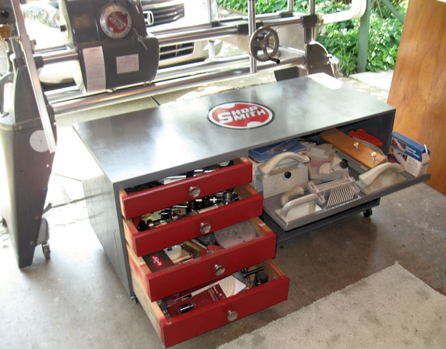

Wanted to show off an "under the Mark V cabinet" I just built so decided to add it to this thread. It is 47" long by 19.5" back to front by 19" high, sitting on 2.5" casters, ie, 21.5" high overall.
[ATTACH]9296[/ATTACH] It is used to store the small accessories, arbors, wrenches, etc rather than any SPTs.
[ATTACH]9297[/ATTACH]
It is on casters so I can roll it back to allow adjusting the table down (or to take the SS off its casters), otherwise the posts hit the cabinet's top. It is made mostly of 1/2" plywood. The back is blank. The drawers just slide on wood cleats. It is painted grey and red. The logo was printed via a computer, transferred using a sharp knife and hand painted. The part that looks white is actually aluminum paint. I have a tremor in my hands so it did not come out as nice as I hoped, but looks ok. (The photo looks better than reality.) The shelf pulls out, which gives better access to its contents. It has metal "L"s to hook under its cleats to prevent pulling out too far.
It is amazing how much "stuff" accumulates for the SS.
Are you happy with the rigidity and strength? I've been thinking of making something very similar, and even a very similar color theme!
Very well done!
Very well done!

That's AWESOME!prmindartmouth wrote:Wanted to show off an "under the Mark V cabinet" I just built so decided to add it to this thread. It is 47" long by 19.5" back to front by 19" high, sitting on 2.5" casters, ie, 21.5" high overall.

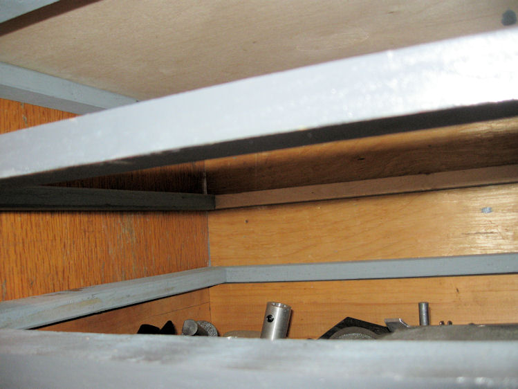

Paul, the rigidity seems very good. ( EDIT: note the top, bottom and rt end are multi layer Baltic plywood so likely stronger than normal plywood.) The drawer portion is very strong.
[ATTACH]9308[/ATTACH]
Drawers have simple lap joints. I actually made just the drawer portion some years ago (15 maybe) and incorporated it into this unit.
[ATTACH]9309[/ATTACH]
The top is 5/8". There are casters at corners and one near middle.
