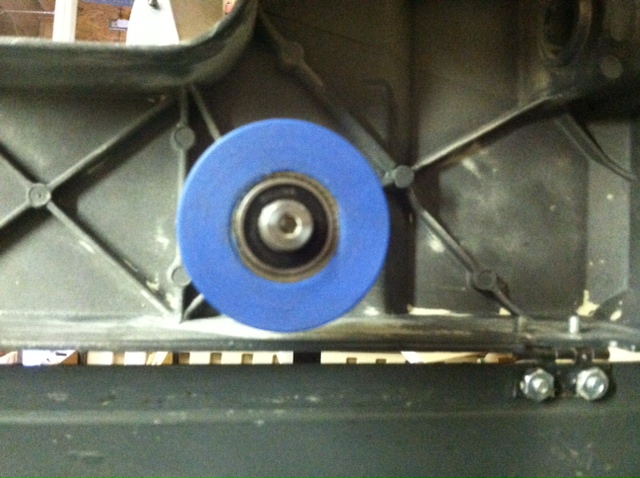

I had posted info re: my new idler wheels in another later thread, but here is a pic of my new bearing centered idler wheel.
Wheel from SUNRAY, INC
I bought two wheels, because two are still at the minimum cost for that Co. The price is high, but the wheels have performed admirably for a year or so with lots of use. I would have worn through several brass bushing wheels by now. The high price ($102.14) has almost paid for itself already. With these wheels, the strip sander is one of my most used tools.
Size specs for my wheels are: 1.875 diam X 1.875 wide. 1603 2RS bearing. These wheels are not in stock - they had to be manufactured to fit my specs. That's why they are expensive per wheel.
I had to buy longer shoulder screws for these wheels. (a few cents each)

charlese wrote:I had posted info re: my new idler wheels in another later thread, but here is a pic of my new bearing centered idler wheel.
Are these wheels made of poly similar to what roller blade wheels would be? Also are they flat on top? What was the time frame from order to shipment? They look great!
Chris

Re: Strip sander help - PROBLEM SOLVED
Chris
Yes, very hard or firm poly. Yes they are flat on the outside edge. Since they had to design and make the wheels from my specs, it took about a month - maybe a little longer before shipping. I ordered on line and then an engineer called me to confirm everything. I called for bearings to be the same diameter as the shoulder screws already on the sander. At the time, didn't know the outside diameter of the bearings, but it worked out just right. These idler wheels will outlast me!
I think the new shoulder screws are 1 3/4". They just fit into the closed case cover.
used existing washers on the inside and the screw head on the outside.
The original metal(with ball bearing) idlers had a flat face and were quite hard! I am not sure that worked well with the idler in the upper/inside sanding position.
