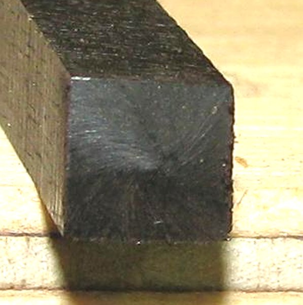

I spent most of the day in town yesterday and ended up having to do some emergency rust removal when I got home (another thread coming soon) so I didn't have much experimentation time last night. But, what I did get to do gave me a lot of confidence.
Making the square holes by hand with a chisel wasn't too hard. I drilled out the center of the hole with a bit slightly smaller than the width of the hole. Then cleaned out the corners with the chisel. Worked great!
I also came up with (what I believe) is a great way to make the square plugs. I was worried about this since they are so small - 5/16" square. Taking a small board that I wanted to use as my plug material, I used a dado blade (in my case, the Craftsman 8" wobble dado that I got with my used Mark V), to cut a rabbet where the material that was left was 5/16". I then set the rip fence on my table saw to 5/16" and ripped off a strip that was now 5/16" square. I made several test/practice cuts first to get the measurements right.
Then, over to the miter saw. I remembered the Wood Whisperer video where he used his saw with the bevel set to 15 degrees to cut his plugs. My miter saw isn't a "compound" one so I just set the miter to 15 degrees. I clamped a stop block to the table to butt the strip against. I then cut all 4 sides leaving a very short pyramid. Tear-out was a problem, but wrapping the end with blue painters tape helped a lot. Some fine sandpaper helped clean up the edges (sandpaper on a sanding block, sanding toward the tip of the pyramid only). Then I used a fine tooth hand saw and one of those cheap plastic miter guides to cut the end of the plugs off. Some more light sanding on the bottom edges to clean them up and give them a slight bevel to make it easier to get a tight fit in the hole. Adjust the stop block on the miter saw and repeat the process.
I'm liking how they're turning out. I've got 11 of the 12 I need cut so far (I'm only inside because LOML lured me in with some hot fresh peach cobbler!) I'm going to cut a few extra just in case. I picked up some ebony stain last night and will apply a coat or two to dry overnight while I work on the holes.
I'll post pictures later, but back to work for now!

Here are the pictures.
Here's the 5/16" square hole I cut in my scrap/prototype piece using a 9/32" drill bit and a 1/4" chisel.
First attempt at a plug by sanding it to size. A good try, but rough.
I didn't take a picture of the process for creating my 5/16" square by 12" long "dowel." So I hope the explanation in the previous post was good enough. I also didn't photograph the actual cutting of the "pyramid" with the miter saw, but here is the end of the dowel after each side was cut at a 15 degree angle. The focus isn't great, but the lighting shows the four sides.
Then I cut the end off with a hand saw and miter box.

After cutting with hand saw:
Why didn't I cut them longer and make the hole deeper so I could handle them easier? Lack of experience, I reckon. I sure wish I had done that now! I don't know why I was so set on making them so short.
Do that 13 more times and I get...
I folded some freezer tape over to make it double sided and stuck each peg to it so they would be held in place while applied the stain using a paint brush for painting plastic models (another hobby of mine).
The sides are laid out with the center points marked and I'll cut the square holes tomorrow.
