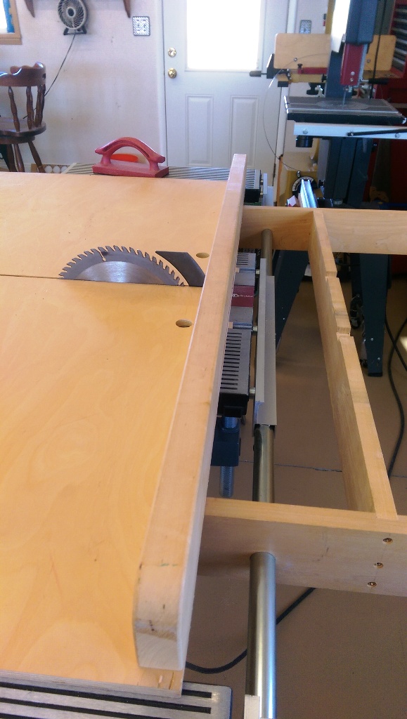

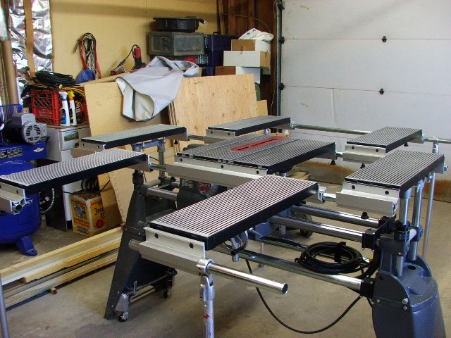

All very good points Dusty. I have the SS sliding cross cut table and it will only cut about 14" max and to do that it really needs support on the in feed side. Also trying to cut that wide you only start out with a few inches of the miter bar in the slot. It is best suited for things no wider than 8" or so.
My big sled will cut 27" and still have the miter bars engaged to the full width of the table at the start. The second picture shows another way to support a big sled. At the time I made my sled I did not have all the extra floating tables and telescoping legs.

Now that's pretty impressive - looks like a battleship!
