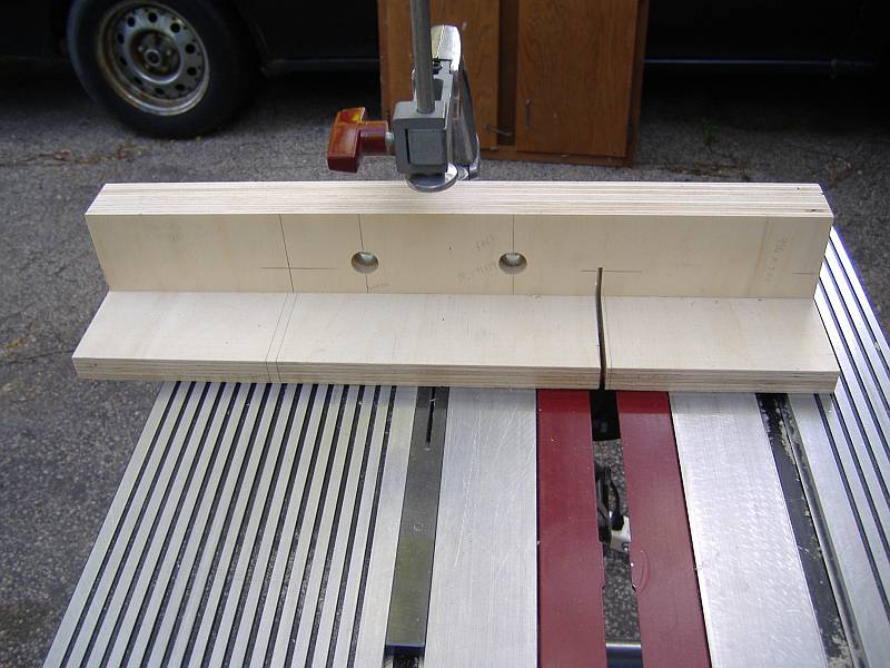

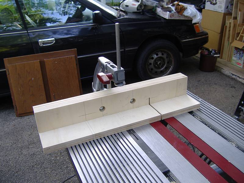

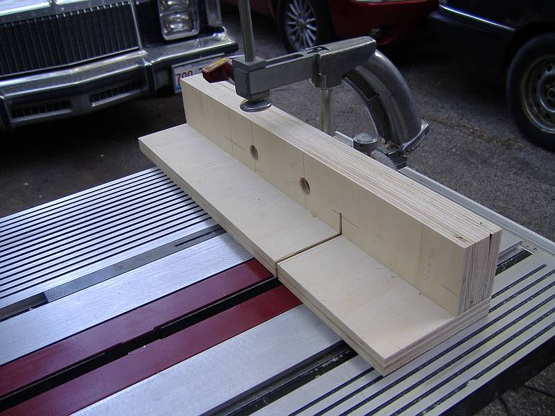

Hi,
This a sled of sorts, maybe a bit different then you would expect but it is for small parts and just uses the miter gauge.
The one pictured is brand new today, an update of a older version I use to use.
Take at look at:
This link is no longer valid...
Pictures are below

Nice sled. It looks like it would be great for making the pieces for a segmented bowl or vase. I hope you won't mind if I make one too.
Sawdust & Shavings,
Woodburner:o
Sled
ed
I too hope you don't mind. I've already cut some pieces to make my version. I'm going to enlarge the table just a bit, final dimensions to be determined.

Ed,
When time permits, could you photograph or explain how you attached to the front of your miter gauge? For the life of me, I don't see anywhere on the front of my Shopsmith Miter Gauge to bolt it on.
Thanks,
Dan
robg
Posts: 44
Joined: Wed Oct 04, 2006 4:48 pm
Location: San Diego
Post by robg »
Dannos, there are two slots in the face of the miter gage. I don't know for certain, but when ever I attach stuff, I just drop the bolts through the slots, hold the attachment flush to the table, and tighten. It's a much more forgiving system then having bolt holes (requiring more precision in drilling the bolt holes in your attachment).

Robg,
Thanks, I don't see how I missed them, (I was going by memory), but I found them last night and plan on creating something similiar.
Thanks!
Dan
Hi,
Just getting back to the forum after a couple weeks away.
Yes the slots in the miter gauge is what is used. Remember to pickup a couple washers and wing nuts for the carriage bolts to make mounting easier.

dickg1
Posts: 343
Joined: Tue Jan 02, 2007 1:31 pm
Location: Northwestern NJ
Post by dickg1 »
Ed,
I see advantages and am going to make one. But, why the extra thick mitre extension?
Dick
