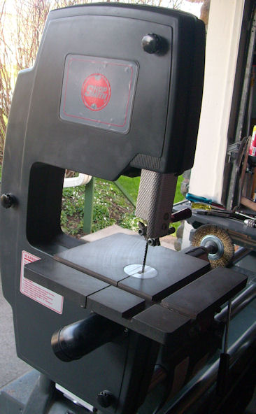

Dust collection -- I'm a little confused by the bandsaw dust collector retrofit that Shopsmith offers. It shows an elbow connector which I find confusing. Does the elbow attach on the outside and point down?

paulrussell wrote:Dust collection -- I'm a little confused by the bandsaw dust collector retrofit that Shopsmith offers. It shows an elbow connector which I find confusing. Does the elbow attach on the outside and point down?
The elbow points whatever way ya want it to. Yes it attaches to the outside of the cover.

Here it is on an older bandsaw.
Peter

prmindartmouth wrote:Here it is on an older bandsaw.
Once again that whole picture=1000 words thing. Thanks!
