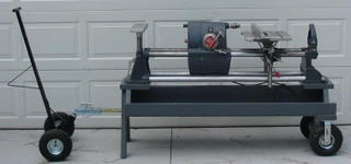

I found you could use a long 3/8" threaded rod in place of the bolts that holds the bench tubes to mount the headrest and base to a platform. You could use the the threaded rod with or without the bench tubes. I would use a nut to lock the rod in the headrest and base. I agree that drilling in the headrest, base or base arm is not a good idea as the aluminum metal is very thin in places and can break around holes when under pressure. I always reinforced any area where I drilled holes on these units. This is my construction Shopsmith I built in 2005 to add an addition to our home. The wooden frame with wheels are available for free to anyone stopping by to pickit up. I cannot just scrap this frame but it does take up room in my garage.

billmayo wrote:I found you could use a long 3/8" threaded rod in place of the bolts that holds the bench tubes to mount the headrest and base to a platform. You could use the the threaded rod with or without the bench tubes. I would use a nut to lock the rod in the headrest and base. I agree that drilling in the headrest, base or base arm is not a good idea as the aluminum metal is very thin in places and can break around holes when under pressure. I always reinforced any area where I drilled holes on these units. This is my construction Shopsmith I built in 2005 to add an addition to our home. The wooden frame with wheels are available for free to anyone stopping by to pickit up. I cannot just scrap this frame but it does take up room in my garage.

The bench tube clamp tapped holes of course!!!:cool: I would add a spacer to prevent the casting deforming.

damagi wrote:Yup, that was my thought...Either ship or have folks cut a spacer, then use threaded rod and bolts to attach to the wooden base. That would at least give you a few more inches for the accessory table. Whether or not that's sufficient to get the table low enough to be interesting is a different story for sure.
I had to drill 1 1/2" holes into the wood platform at each end under the extension table and SPT support tube holes located in the base arm and headrest. The tube holes are 1" but I went bigger at 1 1/2" so my measurement did not have to be exact. The 3/8" long threaded rods is all you need to hold the base and headrest to whatever platform you are using. No holes were drilled in the base or headrest. The base and headrest I used came from a Shopsmith that was not secured on the back of a pickup truck and fell off. Most of the leg bolt holes in the base and headrest were broken out so this was the only solution for these parts. You could use one or more wooden spacers (2X12) under the base and headrest if the Shopsmith is setting too low on whatever platform you are using.
