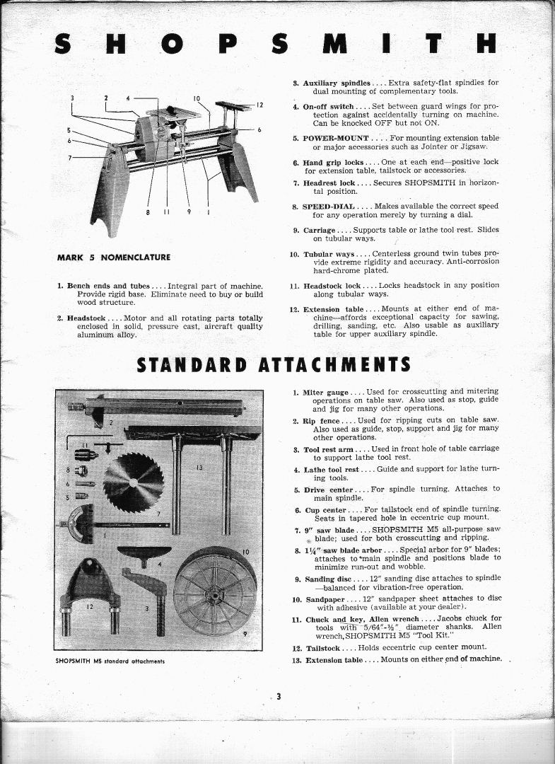

I do not have such a list, but can show you what came with my 1963 Goldie.
Goldie standard accessories 1963.jpg (561.98 KiB) Viewed 54425 times
Should be visible after Admin kills the bug again.

Wow, Thanks JPG!
I can't see from the image, did the table come with a saw guard? If not, it looks like I've got the lot including the casters and a few more saw blades!

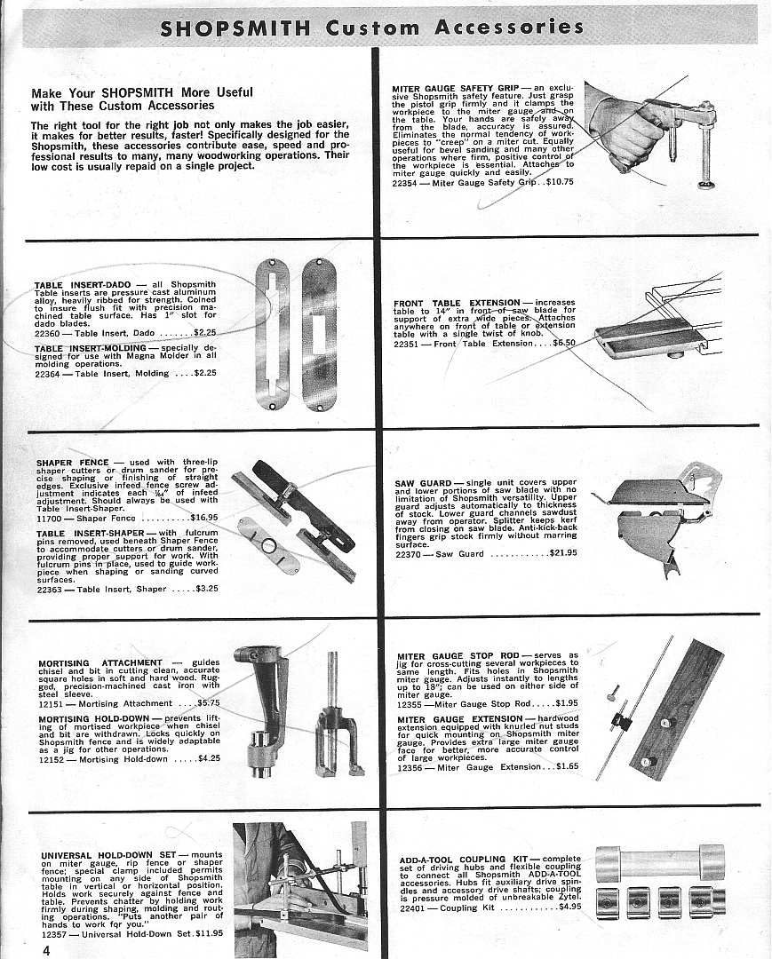

No. It was an 'extra cost' accessory.
goldie optional accessories p4.jpg (693.72 KiB) Viewed 54397 times

I guess so! Back in the day it would have been like spending $200 today.
In reviewing the list, I've got the Table Insert Dado, Add-A-Coupler, Front Table Extension and Miter Gauge Safety Grip. I also have the Jointer. If everything cleans up OK, I'll have a good start.
