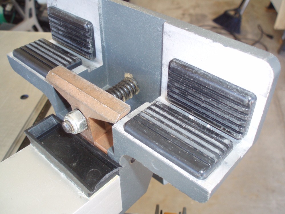

Does the bottom of your fence (the head) look like this?
It really doesn't matter which fence you have. The comments that have been made will all still be valid. There are, however, some potential contributing factors if you have a ProFence. If you do, dismantle it and inspect the head. I don't recall who it was, but some one had a similar problem and found the head to be broken.

The newest 500 rip fence upgrade is essentially a short 510 fence with separate front and rear clamps. IIUC it is almost identical to the bandsaw fence upgrade. If so they all have the 4 screw fence rail/head mount.
Like Dusty I would be suspicious of whatever the head/rail interface is including the screws.
I do not think anything would be 'lost' by complete disassembly and close examination. The 'loose' screw may be partially stripped(as well as the other three).
FWIW, I am less than thrilled with the band saw fence upgrade, and have modified it to make it easier to use.

Re: Pleasantly Surprised By Table Saw Function
I used that fence for a time. I ended up putting a heli-coil in each of the screw holes. The extrusion is very thin there and strips easily. I wish there was room for a tapping plate there.

jimthej wrote:I used that fence for a time. I ended up putting a heli-coil in each of the screw holes. The extrusion is very thin there and strips easily. I wish there was room for a tapping plate there.
Right...this is the newest 500 fence we are talking about...it is very similar to the new bandsaw fence. I suspect that your experience with the stripped holes is what is going on with the loose socket head screw in my fence. The stripped out hole allows just a bit of motion between the head and the fence and that is what is causing the misalignment. Did the heli-coils work for you? and are you still using this fence? Thanks for your input...

Hi Dusty;dusty wrote: Oops. Hold on there. Are we discussing a 500 or a 520 with the new fence. Your comments about 4 bolts on the fence is what has me doubting. Is there a version of the 500 fence that has 4 bolts.
Nope, all my SS equipment is for the model 500. I have upgraded the fences and the auxiliary table and the saw guards and the headstock to the 1 1/8 motor and double bearing quill, added front table extensions and all that other good stuff, but its still a 500. The new fence is nice because of the slot on top for featherboards and stops, but I keep the old fences around because I like the hole on top that accepts the lathe tailstock as a center for sanding disks.
