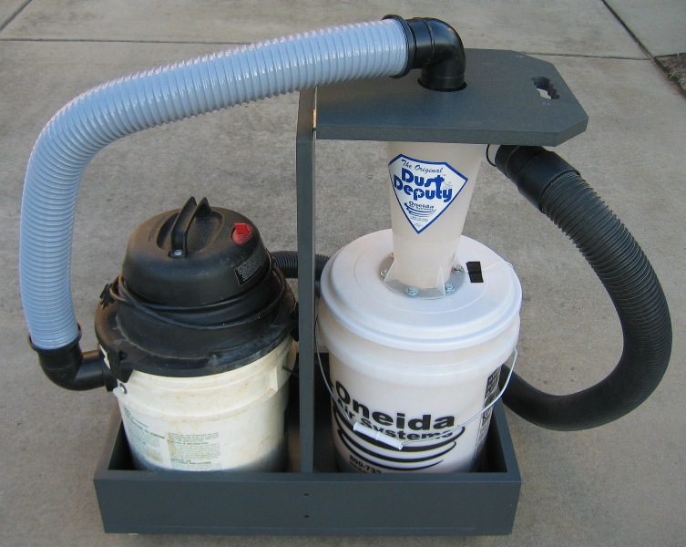

I always wanted a dust collection system but my small shop (a 2-car garage that has 2 cars parked in it
) would not allow it. When I read about the Dust Deputy I thought I'd give it a try. I got the kit that includes the buckets, hoses, and the miscellaneous parts and pieces. I installed it per the instructions, attaching it to the side of my Shop Vac. It worked great and no debris ever appeared in the the Shop Vac container. What I didn't like was the way it all went together - it was quite a contraption that was unwieldy to move around and it took up too much of my precious shop real estate. I also did not like the stress that was constantly being put on the base of the Dust Deputy by the hoses.
I decided that since nothing was ever collected in the Shop Vac container, it could be a lot smaller and have the same effect. I discovered that the business part of the Shop Vac fit perfectly on a 5 gallon bucket - even the clamps worked. After a little modification work and putting to use some MDF that was given to me, this is what I came up with. Now, it is much smaller, easy to move around, and there is no longer any stress on the base of the Dust Deputy. It’s perfect for my (very) small shop.
[ATTACH]16184[/ATTACH]
