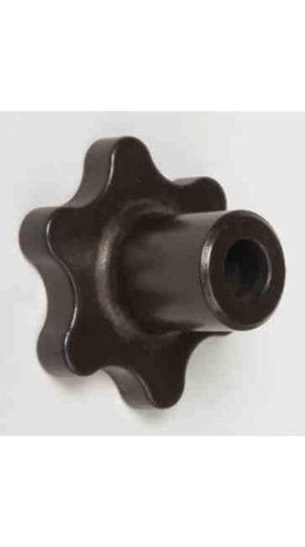

This might be a good solution for some folks (I didn't chase down prices). These are black oxide finished steel in diameters up to 3".
More info:
http://www.northwesterntools.com/-c-344_27.html
Lots of places carry similar in various materials.
They are also easy to make from the wood of your choice on a Shopsmith making the notches with a Forstner bit.
[ATTACH]16162[/ATTACH]
temp steel-hand-knobs-star-large.jpg (16.04 KiB) Viewed 1925 times
