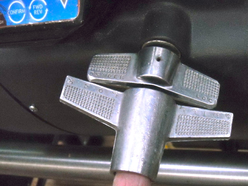

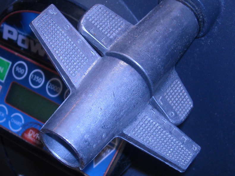

Clip Their Wings
A while back, I got tired of those tips being in the way and decided to trim them down.
I found that cutting off as little as 3/8" from the tips of the wings makes a great difference and there's still plenty of stock left to get a good grip.
In fact, I think it's easier to manipulate the handles when they're smaller.
Maybe my hands are just small or something, but it feels better to me.
I have now trimmed down all the wing nuts on my machine. I just used a very fine(32TPI) hacksaw. For the easily removable wing nuts, I took them off and put them in a vise. For the carriage wing nut, I left it in place and then held each tip with a pair of vise-grips and cut it off after taping a small piece of plywood on the motor pan to protect the housing. I then took a file and rounded-off the edges and then used some fine steel wool to polish them. They feel great to me and fit my hands a lot better.
I will try to attach some pictures. I took pictures with a spare, original-size handle to get a side-by-side comparison.

- shipwright
- Posts: 1165
dusty wrote: I did this by unlockimg the wedges completely. I then grasp the locking handle and pulled it toward me and then pushed it away (three or four times). This alternately engages and releases the wedges from contact with the tubes.
When I locked the headstock, it now becomes secure at 3:00/9:00. I have no explanation - just observation.
Thank You Dusty I have big hands and this has been a nagging problem for me since I first got my 510. Not so much that I would interrupt what I was building to try to fix it, but nagging none the less.
Today after reading this thread I was in the shop using the SS and remembered your advice........................ 10 seconds! Literally! I loosened the wing nut completely and rattled it back and forth a couple of times and tightened it. Problem gone for ever!!!!!!!!!!!!!!
Did I mention Thank You Dusty!
Paul M
