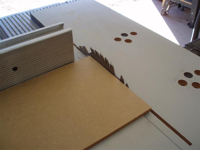

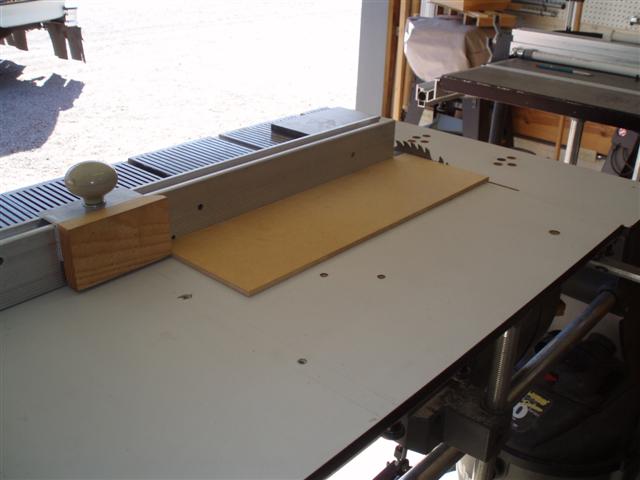

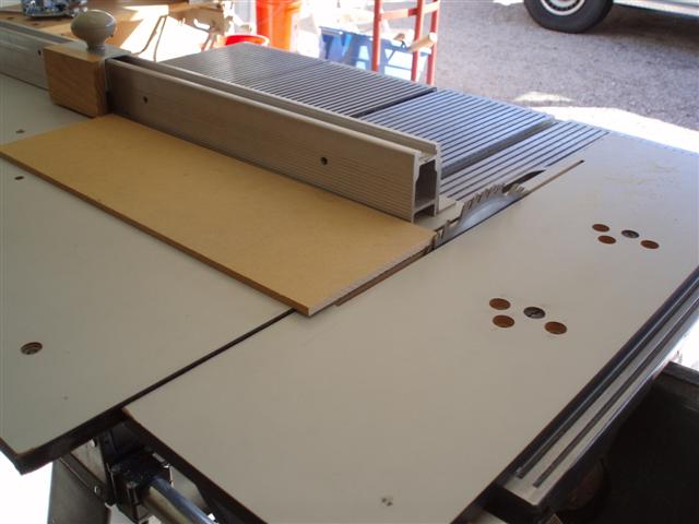

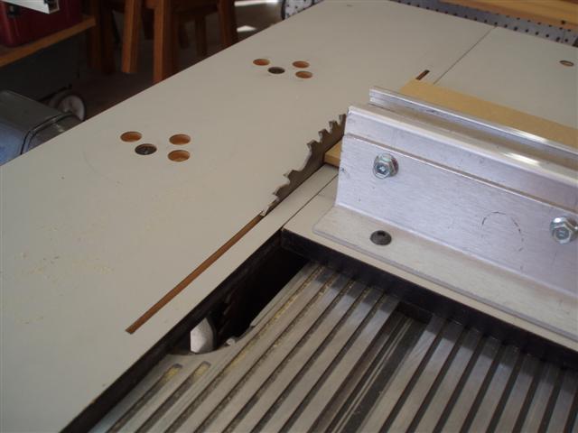

ss50th wrote:A home made sled which straddles both sides of the blade also will have the advantage similar to a zero clearance insert. With the SS sled you lose this function .
NO, that is not absolutely correct.
[ATTACH]16525[/ATTACH]
[ATTACH]16526[/ATTACH]
[ATTACH]16527[/ATTACH]
[ATTACH]16528[/ATTACH]

dusty wrote:NO, that is not absolutely correct.
That addition sure solves the problem. I'm am continually amazed at the ingenuity and innovations found on this forum. Great thinking!!
However, I'm not sure it really works. Please make arrangements to send it to me so I can test it for about 10 - 15 years.:D:D
Mixed feelings is watching your mother in law driving off a cliff in your new Rolls Royce. :) :(
