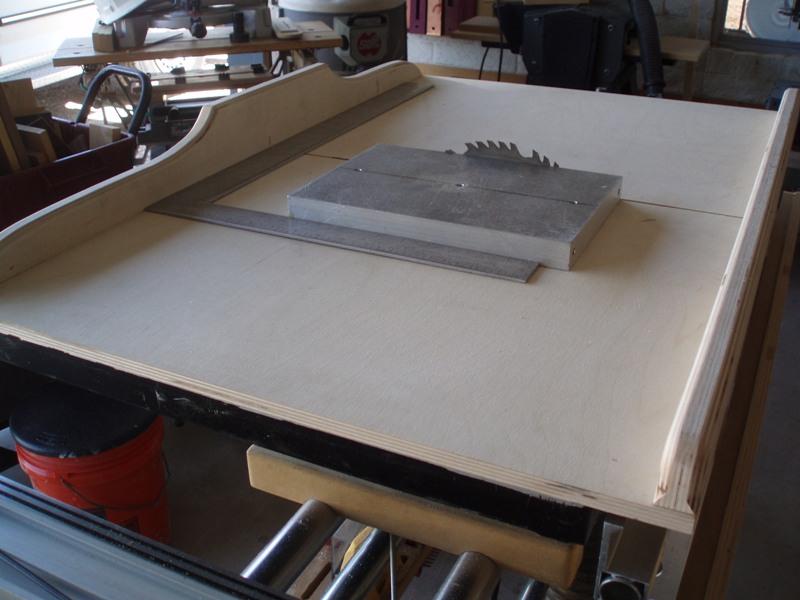

I made my own. The fence is adjustable. I used two miter bars mounted to mate with the two slots on the Main Table.
[ATTACH]16505[/ATTACH]
Crosscut Sled (New) 201 (Custom).jpg (51.23 KiB) Viewed 15830 times

dusty wrote:I made my own. The fence is adjustable. I used to miter bars mounted to mate with the two slots on the Main Table.
Dusty,
I like your setup. Where didbyou get the miter bars?
putttn wrote:Dusty,
On the one in the picture, I bought miter bars from Shopsmith. For the previous version, I made the miter bars.
If I do another one, I will make the miter bars so that I can cut them to the length I want.. I will make them so they protrude beyond the back edge of the table to gain stability when I am just beginning a cut (on a wide piece).

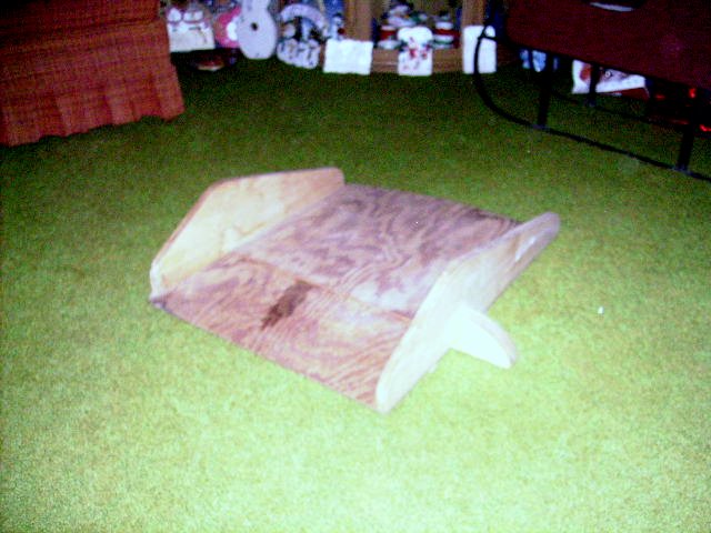

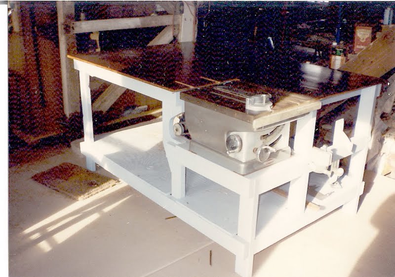

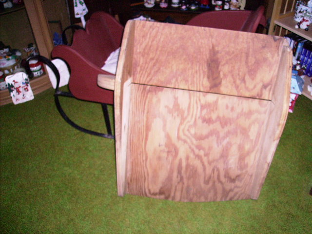

Here is a shot of one I made several years ago. It was a bit of a quickie and I intended to make another nicer one but just never got there. The one feature that I was most proud of on this one was that the exiting blade was never exposed. I have cringed many times watching guys on TV using one and holding the wood to the rear fence with their thumbs resting on each side of the saw slot in it sometimes clearing the suddenly exposed blade buy less than 2 inches. This one was made for my old tablesaw that was mounted in a large 4' X 6' table. The extended mitergauge slots out into the table top served as stops for the sled (two wood miter slot bars). The wood guard sticking out off of the back of the rear fence is about like a quarter of a circle with a slot cut in it for the blade. It's been a long day, my description may be a little wobbly... These old pictures could be a lot better too. :rolleyes:
[ATTACH]16506[/ATTACH]
[ATTACH]16507[/ATTACH]
[ATTACH]16508[/ATTACH]
tablesaw sled 3.JPG (87.42 KiB) Viewed 15595 times
tablesaw sled 1.JPG (81.75 KiB) Viewed 15590 times
Big tablesaw table.jpg (88.36 KiB) Viewed 15590 times

Thanks all, I guess this all boils down to whether or not I can get it square.
Dusty, how do you adjust your fence? I saw a plan some where that used 5 , 1/4 in bolts to fasten the fence to the sled. all but 1 hole (in the center I think) was a bit over sized to allow movement. Several of my research examples are "squared up and screwed in place" which is what I am worried about. most just use a square on the blade and then fasten it. If I use something like the 5 cut method, how do you keep things from moving during the adjustment? I could see myself with hundreds of little pieces of wood and no square fence! I will look at the Wood whisperer again, he always does a good job teaching.
Jim, I think I am leaning toward your solution unless I can get lots more comfortable with some other issues. My precision squares are very accurate, but my technique is sometimes less so.
Francis, I like the idea of stopping the sled with the runners, If I go that route , I will do that. I like your blade cover as well. together they are the best safety feature I have seen.
