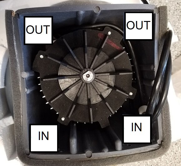

I understand your concerns about that "cooling" fan on the back of the motor, which is why I suggested adding additional fans. Of course, I am hoping that Shopsmith responds with a suitable solution for you. However, if that doesn't materialize, what I was suggesting was adding additional cooling with computer case fans. I have seen them as small as 40mm and sizes up to 200mm. I would think you could get one that should fit in the corner of the motor housing between it and the motor. I included a pic below showing the push-pull configuration that I would do. Essentially, you could put two in the top corners exhausting air out from the top of the motor housing, and then another two on the bottom pulling air into the motor housing. This arrangement should work well to keep airflow going across the motor case fins to help cool it off, but this will only work if that cooling fan on the back of the motor is anemic so that it doesn't interfere much with these computer case fans. These fans are inexpensive so they won't break the bank to experiment with and you can get them in 120VAC versions so that you could easily wire them to the DC-3300. Anyway, thought I would include the pic in case my earlier post wasn't clear. This is just a bandaid to fix the thermal inadequacies of the upgrade, but it would be better if Shopsmith addressed it for all owners.

No worries. It happens on these long threads like this one with lots of activity. A picture definitely helps as well. I know it is a lot more work, but this is how I would "fix" this problem if it were my upgraded DC-3300. The only question is whether the size of fan that will fit in the corners, like I showed, will be enough airflow to cool that motor quick enough to limit the thermal rise to a reasonable level or not. IF they would work, it would at least be a concealed solution that fits inside the existing housing. Of course, if you also can remove that fan on the back of the motor, you might be able to place a 200mm or larger fan in the center of the other 4 fans to help exhaust heat from the end of the motor.
