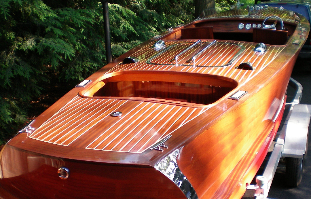

It's definitely an eye-of-the-beholder thing. The engineer in me likes it a lot, functionally. I also think it I will like it aesthetically, especially if the tubing ends have nice clean/polished ends.
And besides, there is good precedent for installing round fittings on beautiful wooden boats. :cool:

BuckeyeDennis wrote:It's definitely an eye-of-the-beholder thing. The engineer in me likes it a lot, functionally. I also think it I will like it aesthetically, especially if the tubing ends have nice clean/polished ends.
Is that your runabout? Absolutely breathtaking!
