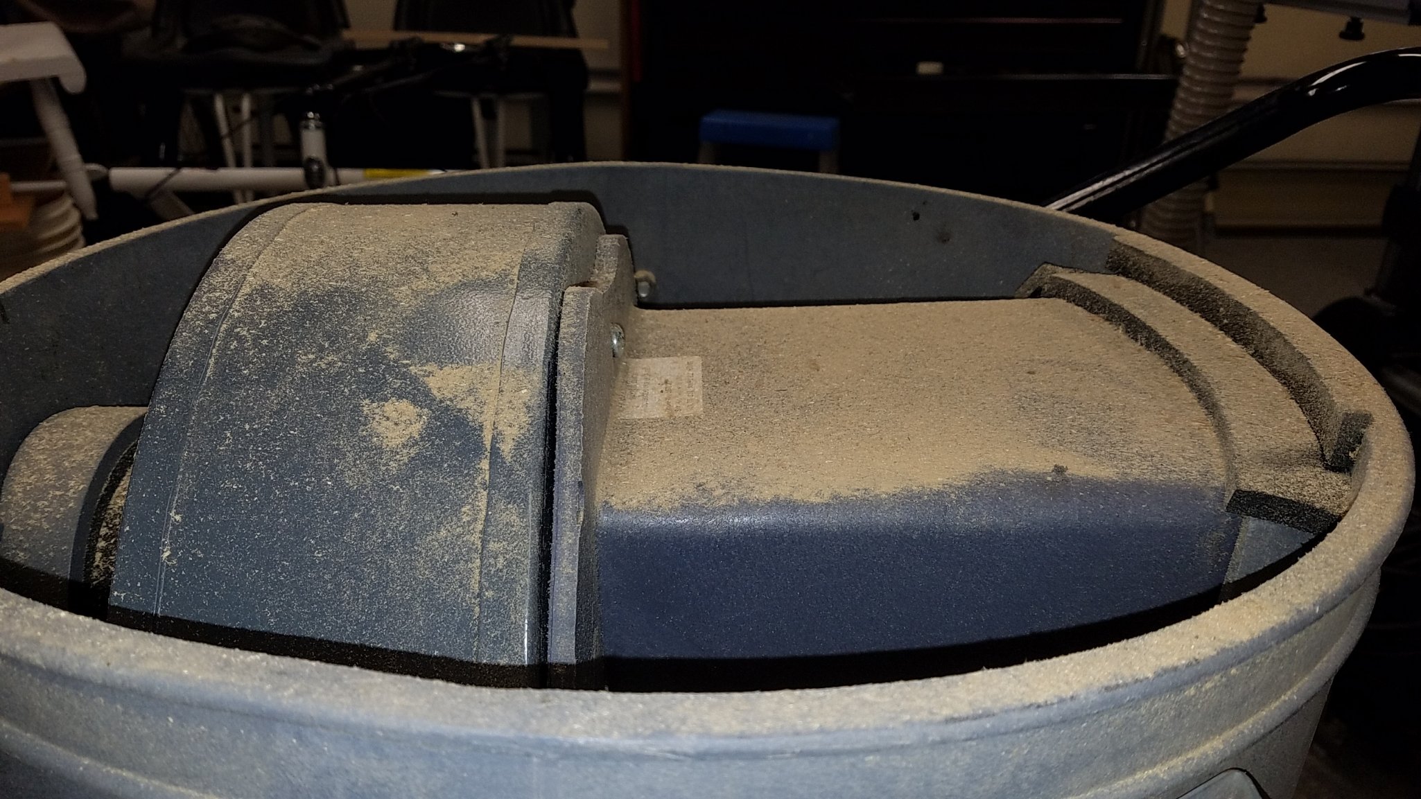

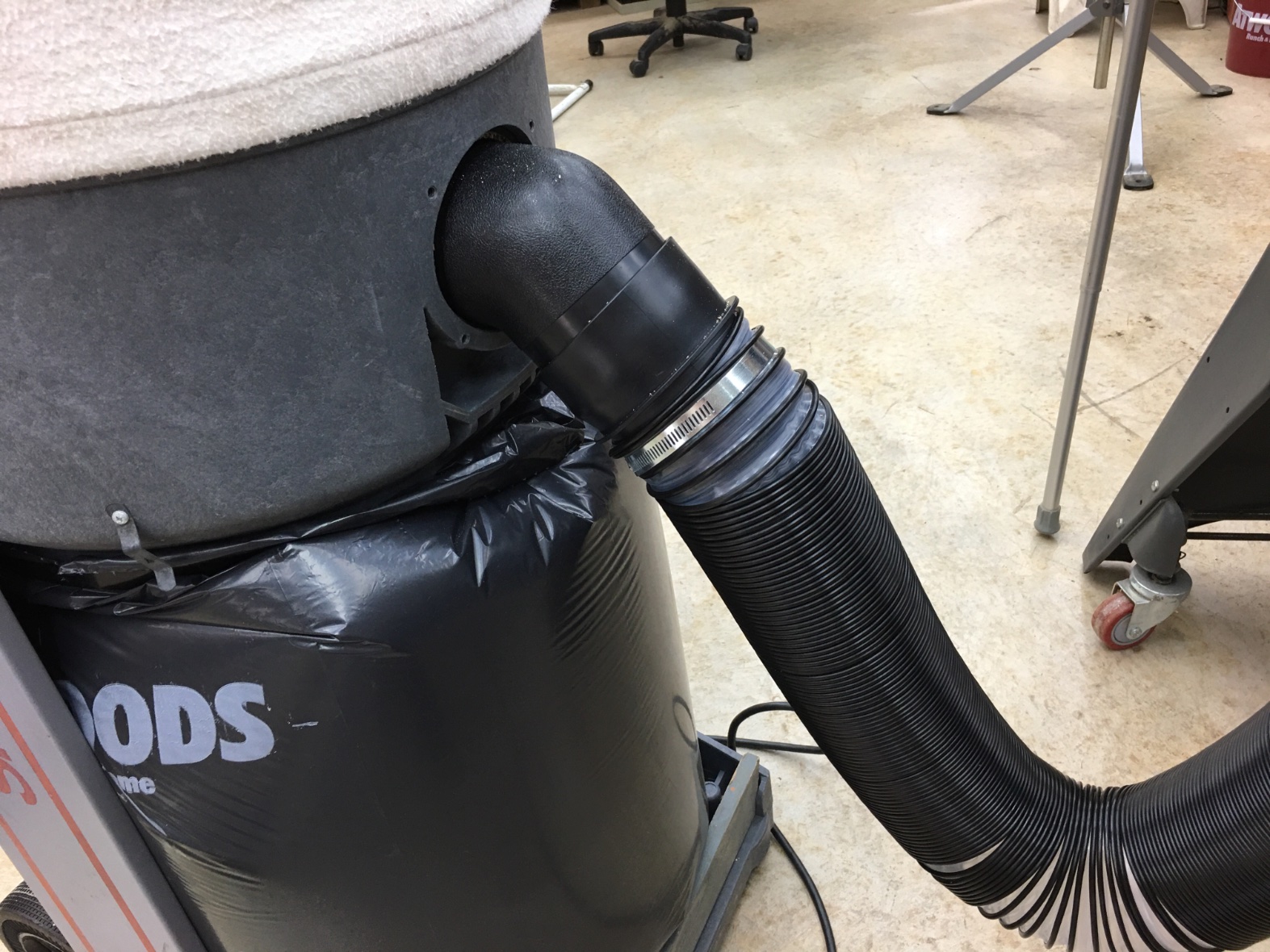

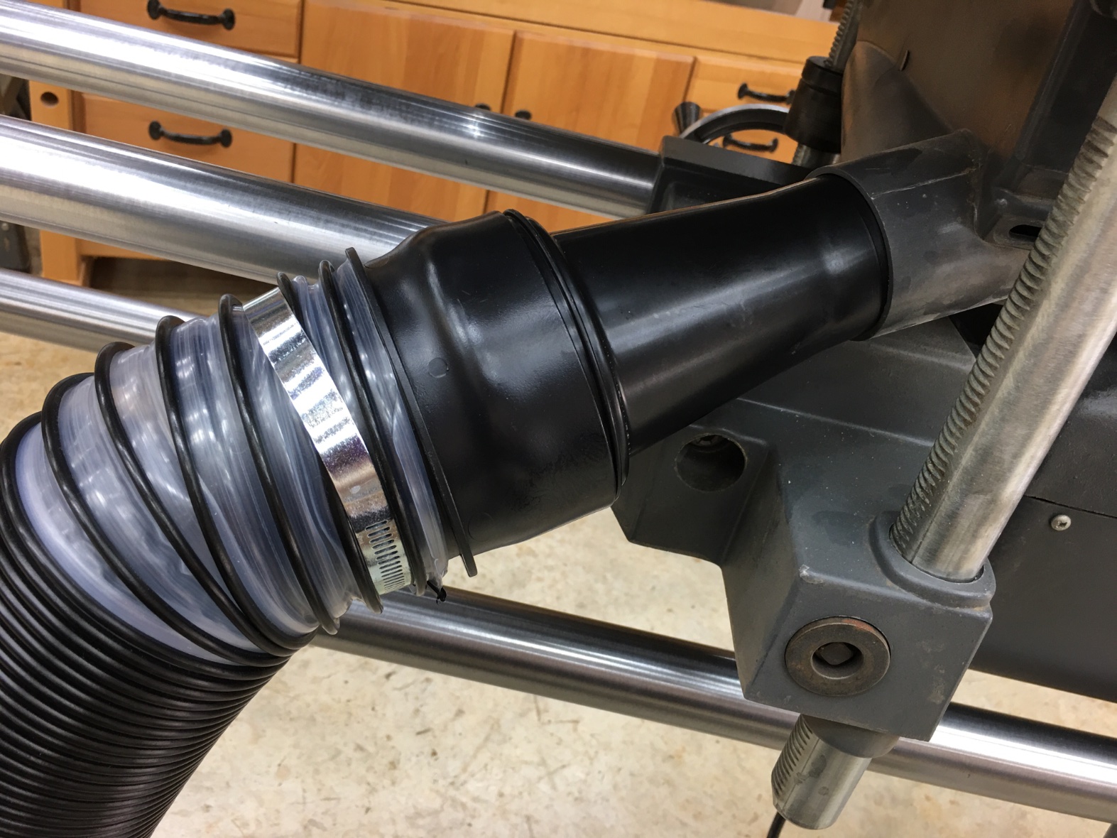

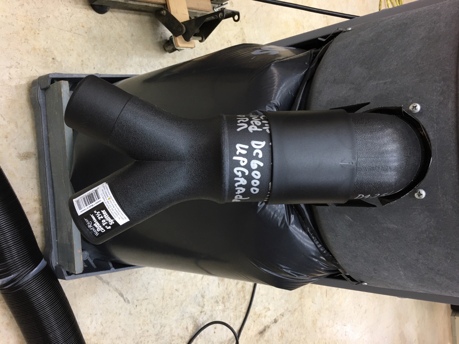

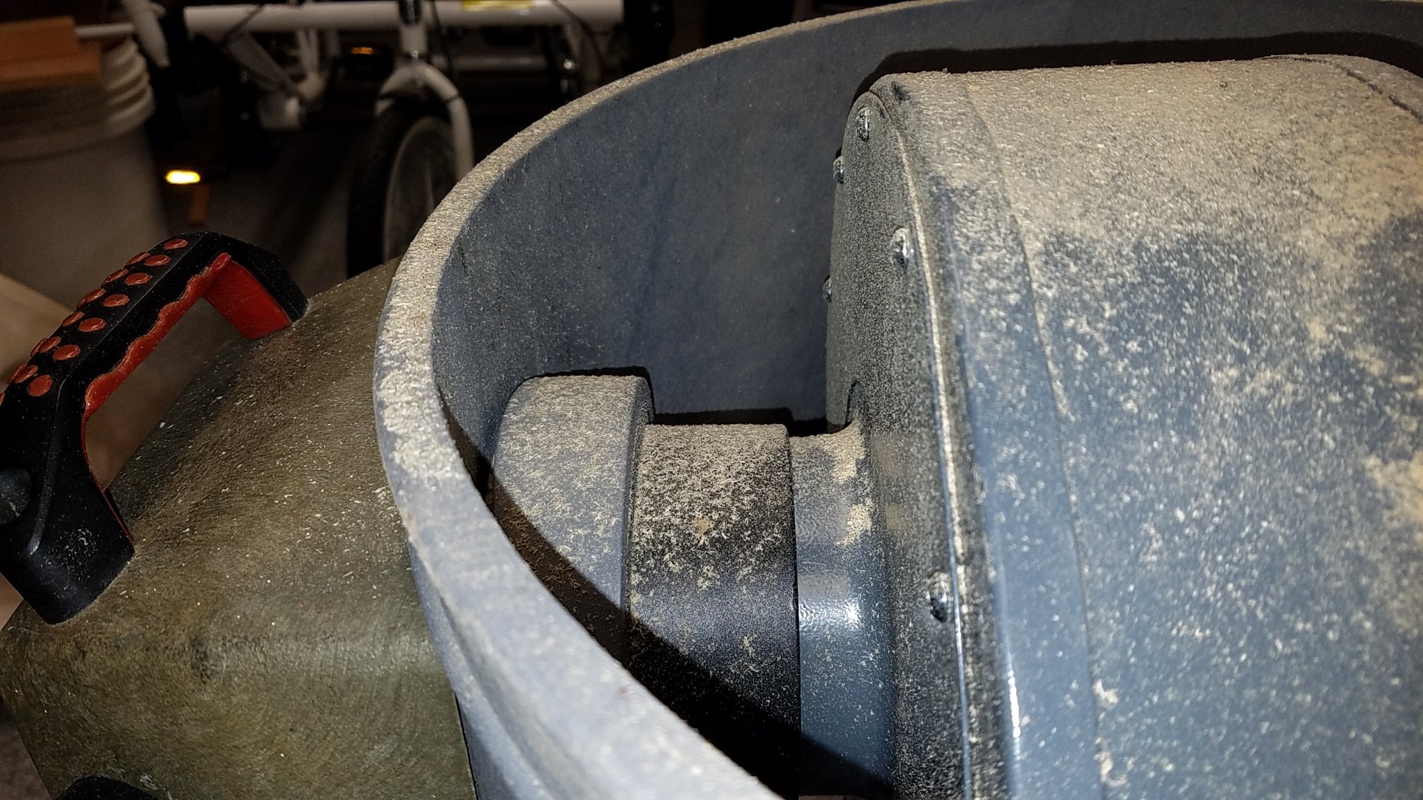

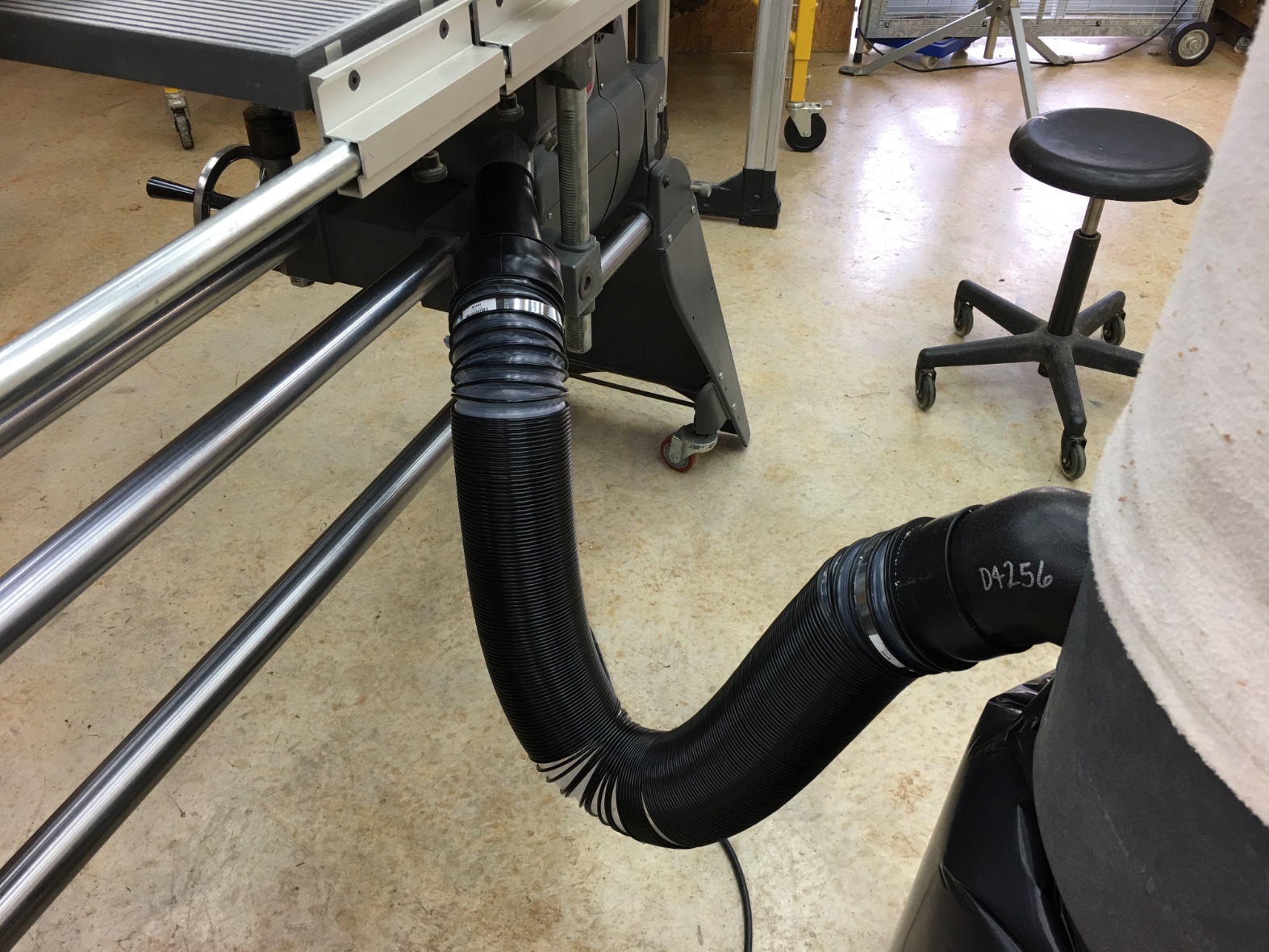

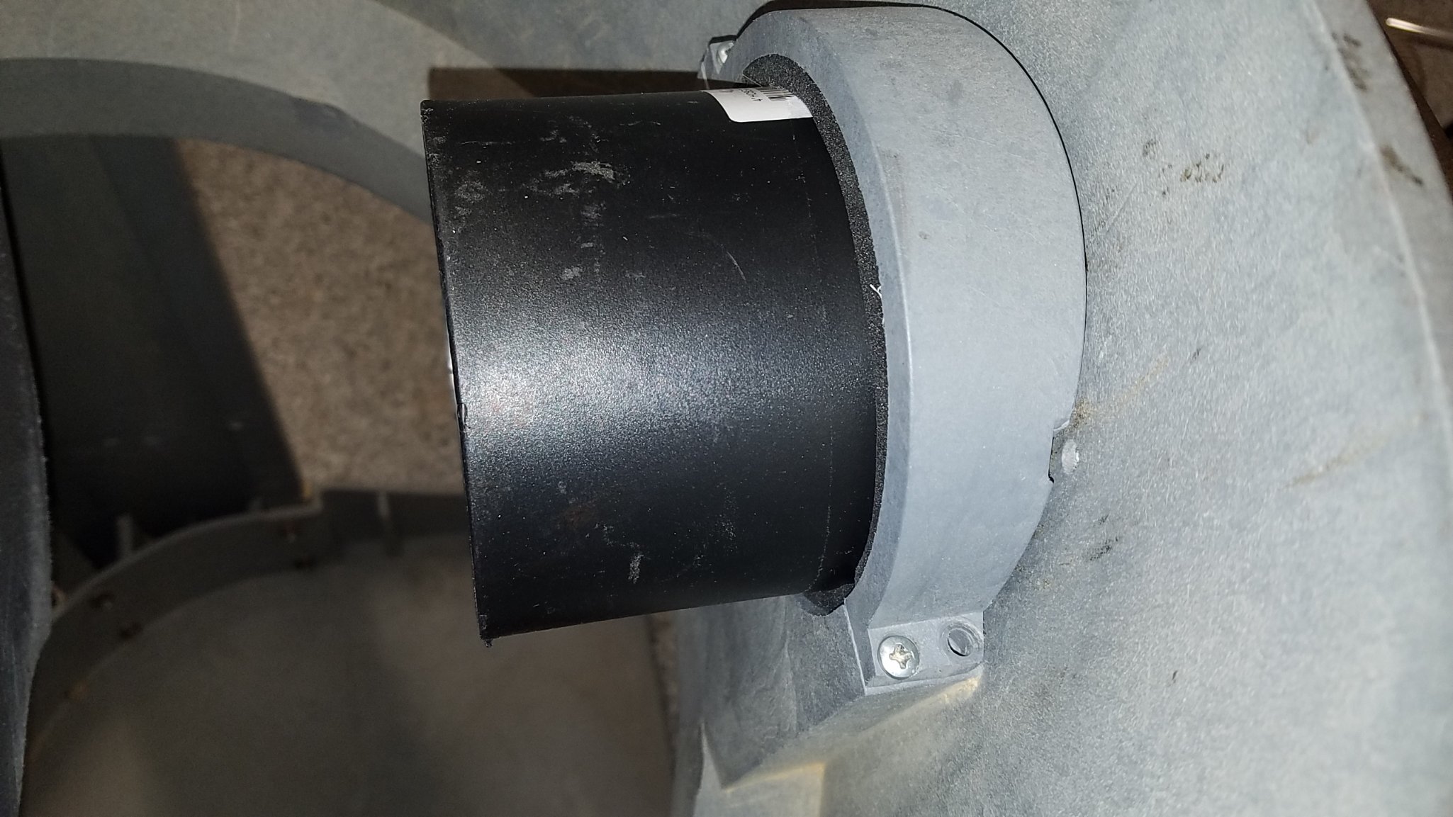

Thought I would share how I adapted my DC6000 upgrade to a 4” hose hookup as close to Shopsmith’s 2-1/2” tool side dust collection pickup point. I only pursued this because I have both a DC3300 and a DC6000. My goal for the DC6000 was to get as much air movement as close to the tool side as I could for large dust producing operations. The DC6000 upgrade kit, as supplied by ShopSmith, has a black plastic adapter the extends from the metal suction side of the blower to the standard external 3-way external hose hookups. This black adapter allows for a non-ShopSmith 4” dust collection to be used. I didn’t have many 4” dust collection hoses so I was somewhat guessing as what to buy. After my assortment of fittings arrived, I still had to doing some adaptive work to make what I bought work. On the tool side, I had to use a heat gun to expand the the adapter that attaches to the hose hose threaded end to female side of the adapter. Then when the adapter was hot, I pushed the 4” to 2-1/4” tapered hose adapter. ( really pleased with how the tapered adapter fit into ShopSmith dust pickup). Then on the dust collector side the 45-degree elbow I bought was just a little too loose, so I had some black heavy duty Gorilla duct tape and I wrapped it around the fitting overlapping it and then used a razor knife to cut through both ends and removed the end pieces for an even wrap. This made for a tight fit into the ShopSmith supplied black plastic extender. I have ripped a few test boards comparing the DC3300 and DC6000 and DC6000 left a lot less dust on the top and under on the carriage too. When setting the gap on the under table dust shoot, I set it wide and not tight to the blade. With the ShopSmith three way hose hooked removed I notice some dust was being blown out of the dust collector so I inserted the 3-way mounting screws into the large round housing and that eliminated the dust from escaping.

This looks really good. Would it have helped if you had been able to bring the 4" coupler further out (like with a 4" x 6" coupler rather than 4"x4"?
I did not convert to 4". I am still using the 3-way coupler but I tightly attached the coupler to the 3-way so as to get a good seal and sacrificed the length available where it attaches to the Fan Housing. I did not apply the foam to the coupler but rather to the inside of the Main Housing.
I also used a different kind of foam tape; a denser foam.
As for the dust that collects on the carriage (and there about), I don't believe you can prevent that with any amount of increase in CFM. Much of that dust gets expelled from leaks in the lower blade guard before the dust collector can capture it.

My DC 6000 upgrade looks very much like your pictures on the inside. I used the foam tape ShopSmith supplied. One thing I think ShopSmith missed the mark on this upgrade kit is the way they fabricated the black adapter, which is cut it straight (square) end that is going through the outer barrel of the dust collector body. The original DC3300 was a more intricate wavy cut that was a better fit for the inside and outside for the front foam seal and top retaining bracket and molded cradle the blower assembly sits in on the front side.

MyDC-3300 fan housing was cut that way too. But I am not sure why. That fan housing had to mate with the inside of the 3-way (manifold) which has a square cut end that mates perfectly with the 4" coupler. I failed to take a picture of that interface but a picture would show a leak free mating between the two (the way I connected it). Making that interface in accordance with the DC-6000 instructions does not provide for that nor would the curved interface.
