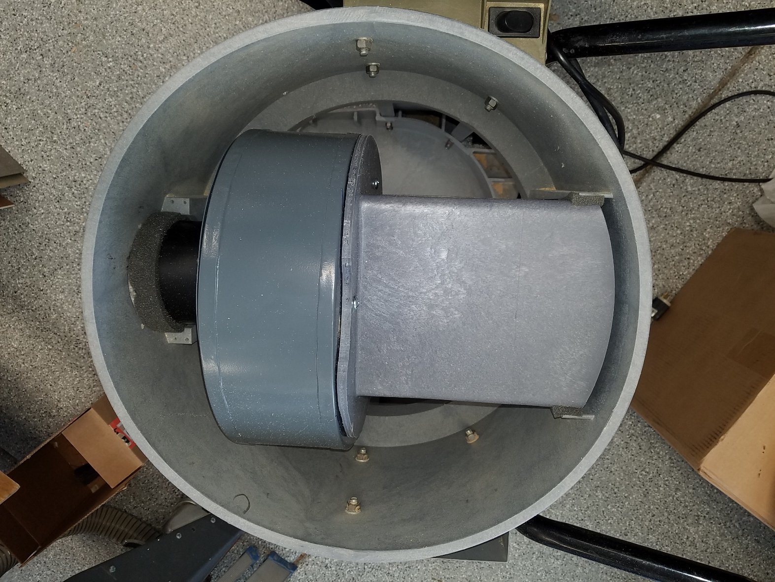

You have resolved, at least for the moment, the same issue that Dave and I had with the DC-6000. The primary difference is that the gap with your DC-3300 is.was a lot smaller than what occurs after the upgrade kit is installed. This is the gap that I had with my DC-6000:
DC-6000 in Main Housing.jpg (389.11 KiB) Viewed 2199 times
Excessive Gap.jpg (376.66 KiB) Viewed 2199 times
I purchased some gasket material at Ace that worked well. It is thicker and wider than what Shopsmith provided. Even then, I doubled up on the layers to further improve the seal. What it looks like now.
Air Gap Sealed.jpg (530.07 KiB) Viewed 2199 times
I have yet to do a lot of heavy work with the new DC but what I have done has indicated to me that I have the problem licked.
The dust that collects in the motor housing is through this gap and with it now closed - I have none in the motor housing.
It has been reported that Shopsmith (Jim) sealed the gap with silicone. Not my idea of a proper solution. The gasket that I have used is better but I believe is still a POOR solution. That huge gap IMO should not be there at all and would not be had the redesign had been completed.
If there is a leak between the motor housing and fan housing I do not consider it an issue. Whatever dust that does move through that leak remains within the DC with all the rest.

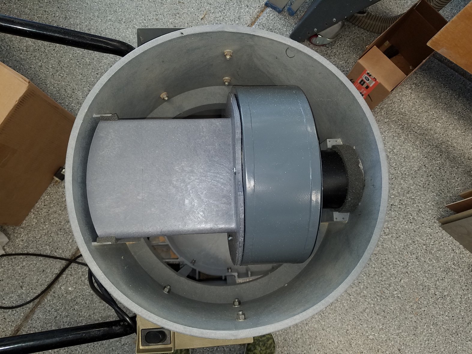

Please, the next time you have the hood off a picture that shows where the motor housing meets the main housing would be greatly appreciated. I am interested in the size of the gap at that location.
If there is no significant gap, I suspect that the collection intake (the 4" coupler") is offset (upward) in the intake opening. I'd bet that your unit is not sealed with the same gasket material that SS put in the upgrade kits.

I'd bet on minimal, if any, differences between the production and upgrade versions. My thinking is that if the OEM was concerned about the big gap the most obvious place to change it is to change the shape of the motor housing so it fits. Raising the other end to close the gap results in the intake end not aligning so well with the hole in the main housing and perhaps interfering with the plenum. I hate to criticize when I don't know all the considerations that went into the design, but the motor housing is a new part which, presumably, allows for an engineering drawing, 3-D modeling, etc. They could have designed whatever was needed. Instead we have what appears to be a reworked DC-3300 motor housing. That approach constrains the design, as you are pretty much limited to removing the unwanted features. Which is exactly what the 'new' motor housing looks like. I hope there were non-obvious reasons for this choice.
