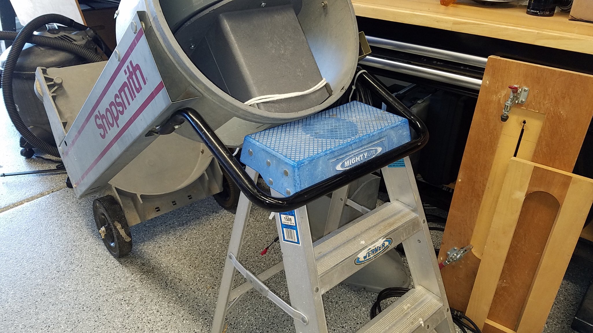

All of this said, mine is now working fine. It dust clear the dust from the table saw and shaving from the jointer much better and it may even be a bit quieter.
I even devised a method whereby I could manage the motor and fan housing assembly with out assistance.
