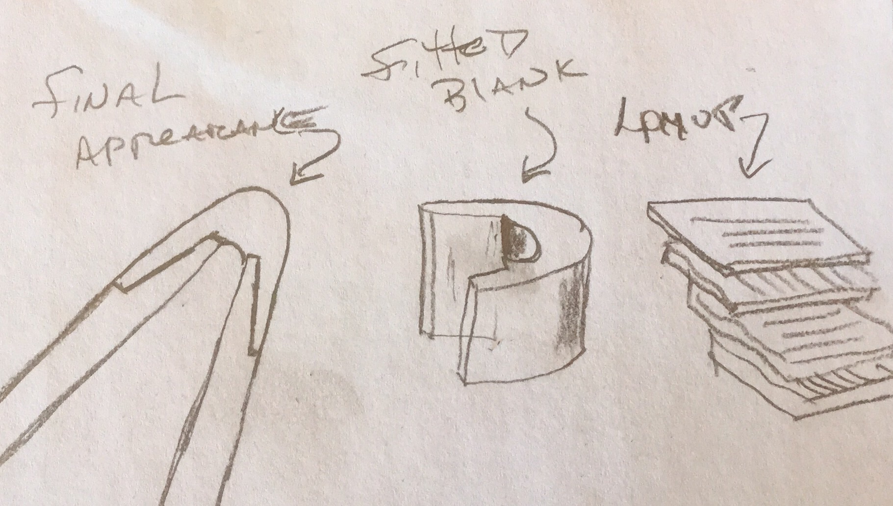

It would be what boat builders call a "fashioned" piece, meaning basically that you would do your joinery with an oversized block and then sculpt it to fair in with the desired appearance.
If I were doing it I guess I'd choose a stepped scarf joint (traditional for this type of joint) and glue up a block with alternating grain directions to fashion the pieces from. .......sounds harder than it is.

shipwright wrote:It would be what boat builders call a "fashioned" piece, meaning basically that you would do your joinery with an oversized block and then sculpt it to fair in with the desired appearance.
It sounds really, really hard! Plus, if I can't see it....

Sorry for the Q&D sketch.
Thanks for the sketch, it is self-explanatory. I like the idea a lot. Making up the blank would be a breeze. Fitting it and making the joints looks like it could tax my limited hand tool skills! Let me think about it. It might even be something I add over the winter.

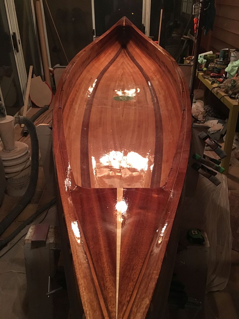

Got a few more coats on the decks/gunwales and a new one in the interior (interior already had 2 coats but had to sand back quite a bit to get rid of the worst drips). It isn't perfect by any means but I think it is good enough.
Once these are dry, I'll flip it and work on the outside. So close!

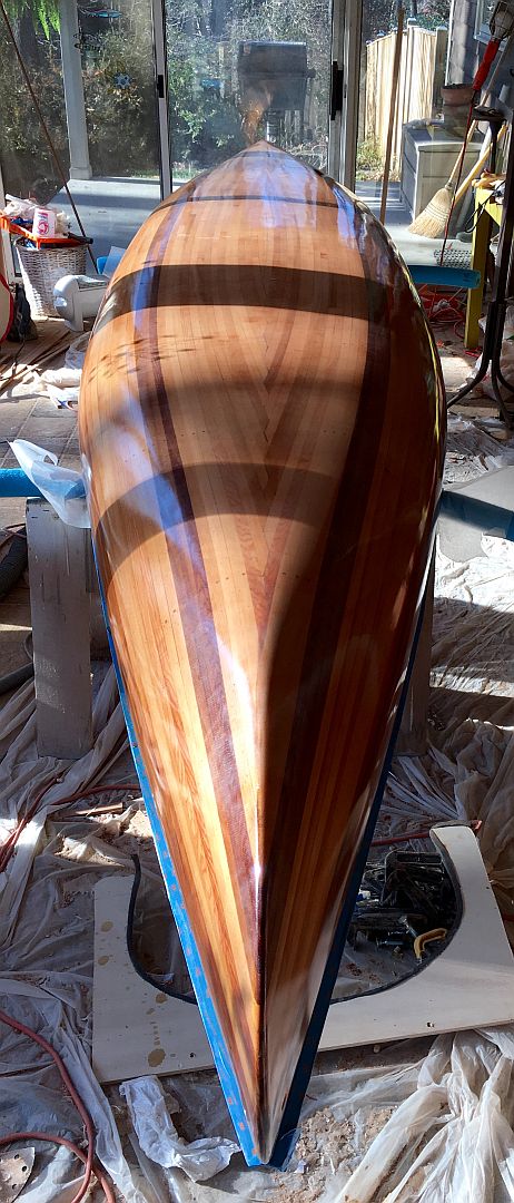

Notice anything different? :rolleyes:
So much easier varnishing the outside! One down, at least one more to go.
