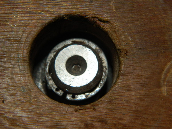

After cutting the hole in the headstock I rounded off the burr using a dremel type bit in an old Foredom tool. If you don't know these it's a variable speed rotary tool with a flexible shaft and a handheld bit. Jewelers use them. I think mine used to be a dentists drill. I've never owned a proper dremel. My wife gave me a HF knockoff with a bunch of bits. The tool died qucikly but I still have the bits that came with it. I like using the Foredom because the vibration of the motor doesn't tire your hand as much.

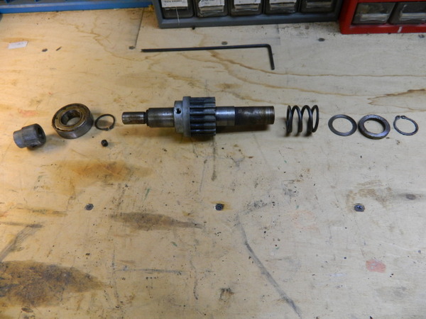

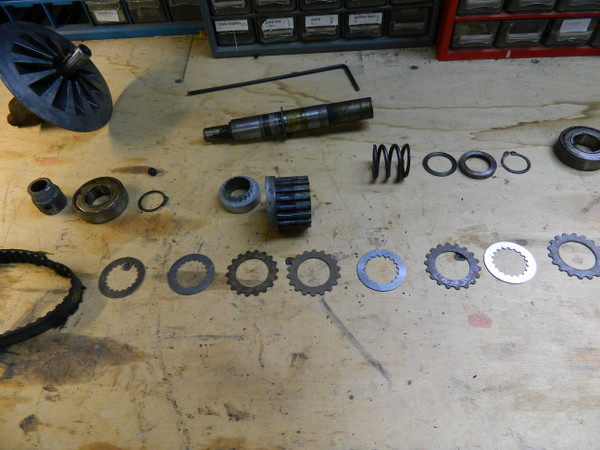

As to other progress, following mickyd's thread on the gilmer drive a went through that process and thanks to that thread it went smoothly. Here's a few pics:
[ATTACH]17306[/ATTACH]
disassembled:
[ATTACH]17307[/ATTACH]

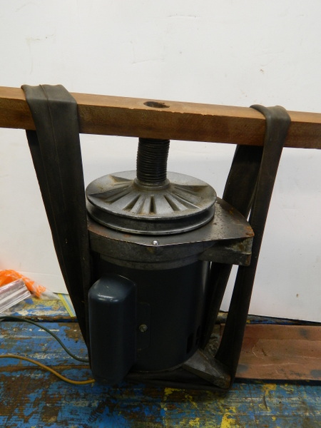

To re-assemble you must compress the spring and re-insert the snap ring. Folks have used different methods to do this- here's what I did:
[ATTACH]17308[/ATTACH]
Not a great pic, it's a makeshift press using some cut-off mahogany bits from our recent porch remodel ( there short but I can't bring myself to toss them, we have buckets full.) and using the drill press to, well...press. The other end of the shaft is sitting in the hole in the drill press base. Here's a pic of the assembled shaft with new bearings (from the nearby Local Motion outlet) in front with a poly v shaft in the rear. And the tapped & drilled nut used to test for torque.
[ATTACH]17309[/ATTACH]

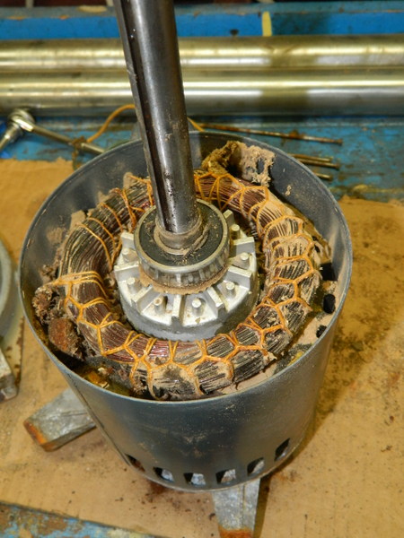

Painting done and we're fully into mechanicals now, obtained quill and motor bearings from McGuire bearings in Portland. They have Saturday morning hours. I am in the middle of it all right now, slowed considerably by extra time at the day job today and tomorrow too. Plus the fact that now that the weather has turned we must now mow grass every weekend, and its full on garden time with everything to be planted.
I will post pictures of the ongoing work on both motors, there is not much difference between the two motors- I was expecting more of a difference actually.

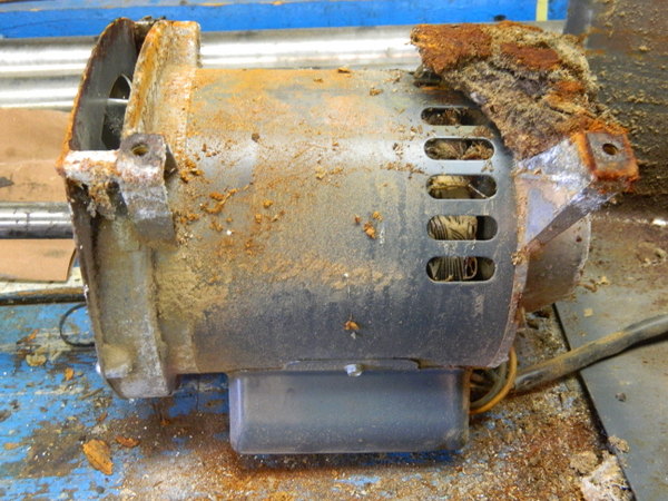

Although the Green is almost 20 years older the gray is putting up much more a fight getting things apart. It was full of impacted sawdust, the motor was really packed. Here's a few pictures:
[ATTACH]17356[/ATTACH]
You can see a great lump still clinging to the motor immediately after removing it from the pan.
[ATTACH]17357[/ATTACH]
You could hardly get more sawdust into this motor than what's in here now. Completely solid, and yet it still ran.

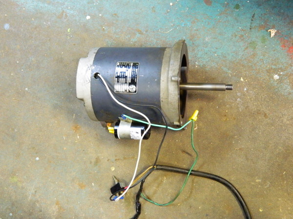

Getting closer to having two fully functioning SS motors. When testing the gray motor with sheaves assembled it started slowly and then blew the breaker- classic symptoms I find after a quick forum search. Possibilities are bad capacitor or stuck contacts. Well I inspected contacts and found them fine and then pulled the capacitor off. I was surprised to find even the capacitor cover was full of sawdust. I had another spare capacitor from a different motor, a much larger one, that I wired in as a test. This time the motor spun up and made a shrieking sound of metal on metal. As soon as the motor spun up the fan sheave started rubbing on the motor cover, another classic problem. There's even a pdf available on the problem. The lesson for me was "tighten the setscrew, dummy". Probably got overlooked during assembly. Couldn't find the little bottle of loctite so I'm hoping it stays tight.
I returned to the original capacitor and now its running fine.

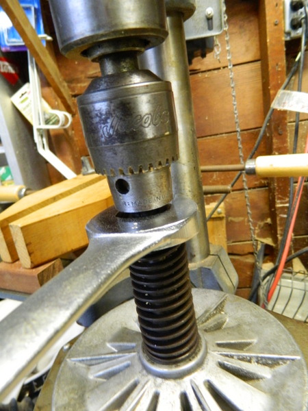

On the newer motor the spring is held on with a snap ring- the older one with a left hand threaded nut that screws on to the end of the shaft. The snap ring is easier to deal with using a drilled out piece of wood to compress the spring:
[ATTACH]17533[/ATTACH]
-like shown in the sawdust sessions, then you get the snap ring:
[ATTACH]17534[/ATTACH]
The older style takes a different approach. I compressed it with the drill press, locked the quill and the got a one inch wrench on the nut, remembering finally to turn left:
[ATTACH]17535[/ATTACH]
I suppose a person could break down and get an actual spring compressor, or make one, if you needed it often enough.
At any rate after tightening the set screws on this one, it too is running. The potential problem is that the outer pulley is sticky. It is harder to pull out that the other machine, and unlike it the pulley when pulled out wants to stay out. A light tap will persuade it, but it doesn't seem optimum. I did drill an oil hole in the pulley through the key way and installed a new piece of key stock from Mcmaster's. Maybe one of those is making it stick? Anyone encountered this? I did lube it generously.
