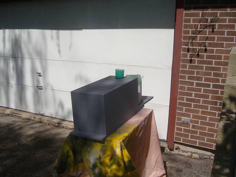

While I was waiting for it to warm up enough to paint I found another use for a #10 nest box. It is the new cup holder!
[ATTACH]17078[/ATTACH]

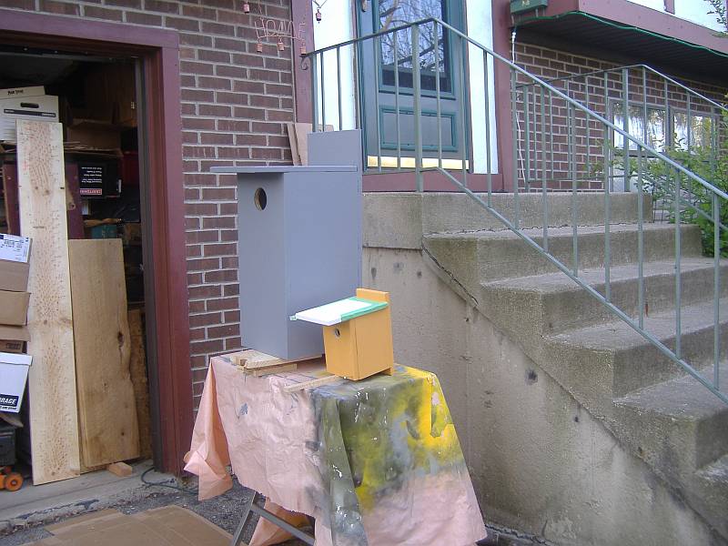

I was able to finish painting (two coats, one yesterday, one today) the big box. The small box has the roof done and a single coat of the St James Farm yellow. Weather permitting the second coat of yellow will be on and if I get an early start the box may even go up late in the day.... Number 10 will be a few days or weeks when my back feels better. Over did it today.
BTW the green on the small house if painters tape.
[ATTACH]17079[/ATTACH]

[ATTACH]17111[/ATTACH]
I was hoping to be finished today... but the green masking tape monster struck... didn't buy the frog brand and this green stuff is no frog tape. Tomorrow I'll give a small brush a try or go buy some frog tape.
