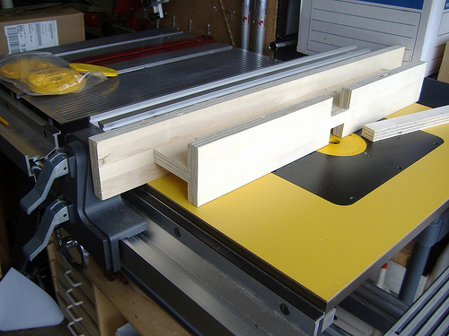

Table fence, note gap between main table and extension table so clamps can be used.
[ATTACH]2842[/ATTACH]
Note that fence can be at any angle and still work.

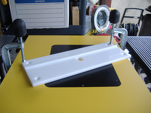

Box Joint Jig, might need to use a different set of clamps... Oh I don't know I think it will work like this.

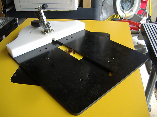

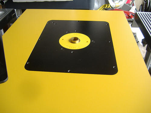

1" guide bushing
[ATTACH]2845[/ATTACH]

Miter gauge uses the guide bushing

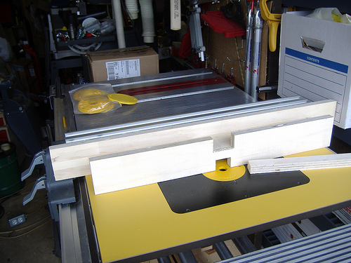

The 520 rip fence is mounted on the router table and the added fence is for bits that are used buried in the fence.
[ATTACH]2848[/ATTACH]
These are easy to make and is a good way to make use of the 520 rip fence with the router table.
[ATTACH]2849[/ATTACH]

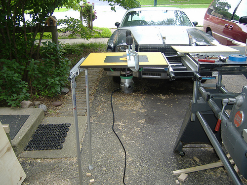

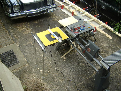

Here are two more that I think fit in this collection.
extension table brackets holding router table behind the shopsmith main table
[ATTACH]2877[/ATTACH]
Jointech Router Table
Mounted to Shopsmith using
555997 extension table brackets
[ATTACH]2878[/ATTACH]
BTW I really like the flexibility offered and I'm one that likes to use it too.

You seem to use the Router Workshop fence setup more than the SS fence setup, it that correct or just the way it pictures were taken?
Your selling me more and more on the jointech setup for a router table choice. In one of our past e-mails you mentioned that the Router Workshop table insert inserts used a bigger guide bushing hole than the PC standard. Which one does the standard jointech table insert use?
If it is the PC standard size (whatever size that is) does the Router Workshop jigs work okay with it?
Ed in Tampa
Stay out of trouble!
Please note that while everything posted here is with the Jointech stuff that is because that is what I have but the shopsmith version should work about the same way.Ed in Tampa wrote:Ed
I have to admit I do like to use the Router Workshop fence and setups, not sure how the split of usage would go because a lot depends on what the project is.
The Jointech router mounting plate that comes with the system has the inserts that fit in it. The insert to hold guide bushings is the the pc type, that being the smaller size. The barrel portion of the guide is what counts for using jigs and the 1" size is what the Router Workshop jig shown uses, so all is well on that front.
I don't see an easy way to change the insert on the jointech system so I have purchased another router plate that I will drill to take the larger guide bushings.
