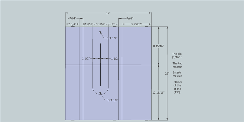

If the correct front boss surface to rear boss surface dimension is not 22", it is very close! I looked at all three aux and the main early 510 tables and a later 510 aux table that I have.
I measured the boss to boss dimension, not the table edges which are tapered.
520 Extension Table/Fence issue
My main table measures 22"x17". The 22" measurement is boss to boss. Otherwise the table measures 21 7/8"; the bosses are 1/16" thick.
I was able to measure seven spacers. They measure .314" +- .001".
[ATTACH]17820[/ATTACH]
- Anatomy of the Shopsmith Table Top (Custom).png (42.54 KiB) Viewed 2234 times
