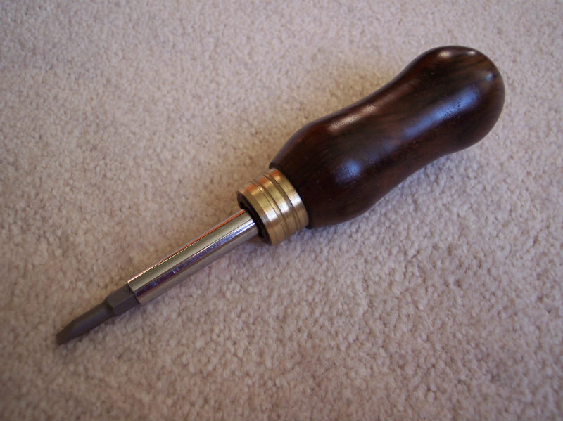

If you happen to have a tool that you can finish-turn after putting the ferrule on, it can be taken to the next level:
[ATTACH]24627[/ATTACH]
- turned_screwdriver.jpg (94.82 KiB) Viewed 5740 times

The added detail is nice. I hope I can remember this when I do a screwdriver project (another thing I like to do).

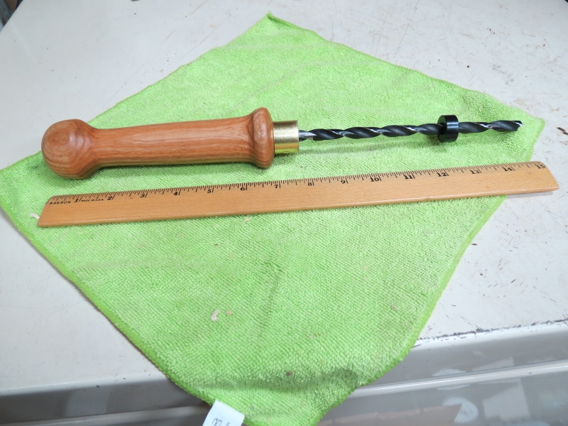

Just finished another tool. This it is a drill bit in a handle.
This is still lathe related. This is one way to mark the depth of a bowl, find the depth you need, mark the bit, drill in that far and then stop when the drilled hole runs out.
The one I referenced used a 3/8" bit so I follows that lead. As you will it is a brad point but I'm thinking a regular bit would work as well. Just remember to account for the brad point in your planning.
The tool is just under 15" long, handle made of ash. The stop is part of a set of 7 split ring collar I have for just this sort of thing.
[ATTACH]24939[/ATTACH]
Will give it a try after the epoxy has time to setup. I really like the shape of the new handle for this application, feels good in my hand.
