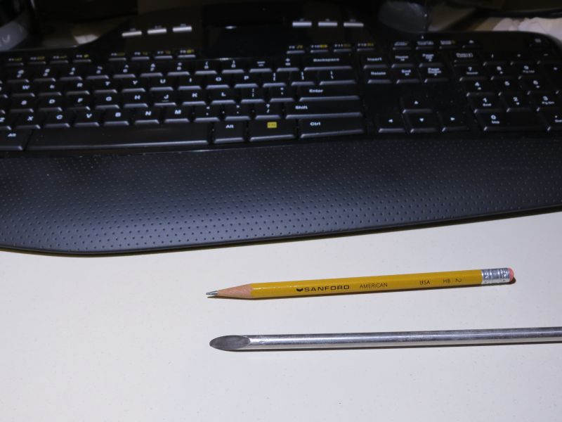

So after watching some youtube videos and having the general inclination to give this a try, it happened today.
First despite having heard that Ace Hardware had 1/4" stainless steel rods in their stores this doesn't seem to be the case here where I live. So I used Amazon and got a 3' section for a little less then $10. I had other "stuff" to order so I made the $35 and got free shipping.
The rod came well packed in a tube, but, well the rod was not straight. I'd have to say it was put in the tube that way so I wasn't very impressed by that.
The good news is that my plan was to cut the rod in to 9" pieces so the bend will not be as obvious and should not effect things too much. Today's posting will be a bit of an over view as this is very new to me and I don't want to mislead anyone in to thinking I have this all worked out.
One tool I don't have is something that can do small detail work. A recent project (making an owl call) required me to cut some rings for o-rings and they came out wider then I would have like them. Before I do the second call I want to have a "better" way to cut those rings.
I've seen three designs that would appear to do what I want. I plan to build each of these designs. The first is just a simple flat grind at 30 degrees. The others are variations on this.
I started by cutting what I hoped would be about a 30 degree angle 9" into the rod. I did this because as I mentioned, the other tools have this same angle. Now I have a 9" section with the angled cut and the remainder of the rod also cut with that angle.
I went to my 8" bench grinder and refined the angle and flatten the cut. I did only the very basics as the round of the wheel shows up quite quickly on that long an angle. Grind and dip in water to cool many many times as I wanted the edge to stay cool.
Ones I was happy at the grinding wheel I went to the shopsmith strip sander with the sharpening fixture attached. I started with a 60 grit belt and the angle set at 30 degrees. Once the arc of the grinding wheel was gone I started working my way up with finer grit belts. The fines one I have is 600 so that is where I have stopped. I can go finer but I don't know if I need to. I'm also wondering if I want to go to a leather belt and polish the whole tool........

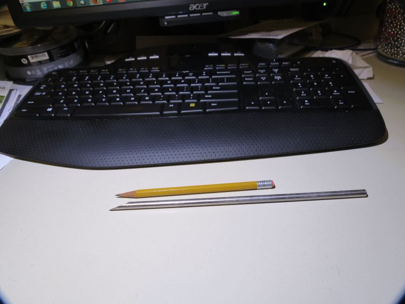

Here are two pictures that show the state of the tool at this point.
[ATTACH]24377[/ATTACH]
[ATTACH]24378[/ATTACH]
I want to do a second version like this but with the bottom of the tool rounded near the tip. Maybe tomorrow??
Haven't started to think about the handles yet but of course I'll want a handle before I try using them. That might be a week or more out yet.

- IMG_1402sc.jpg (48.07 KiB) Viewed 6482 times
- IMG_1403sc.jpg (49.8 KiB) Viewed 6483 times

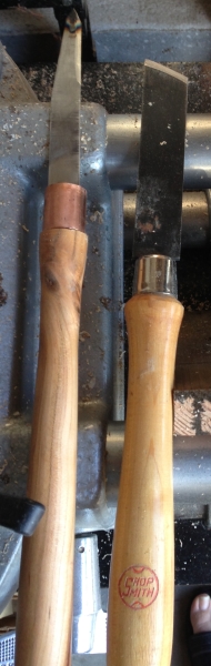

I agree with you Ed. Lathe tools tend to be spendy and I support your decision to try making your own. I'm looking forward to the results. As for handles, just grab whatever cutoffs you have, drill the correct size hole for the stock and turn them to the desired shape. I mean, you have a lathe and some turning tools already. Epoxy the handle in place. I made a thin parting tool from a dull reciprocating saw blade. I used some plum stock for the handle and used a section of 3/4" copper pipe that has been in my shop as a ferule.
Here it is next my SS Skew for comparison
[ATTACH]24385[/ATTACH]
