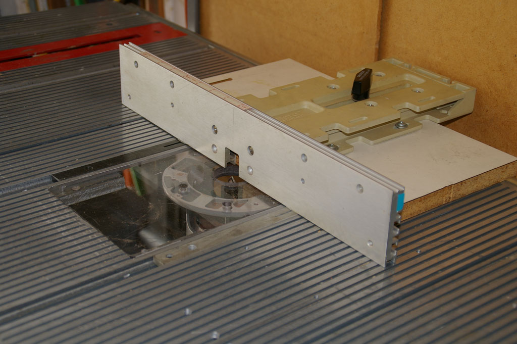

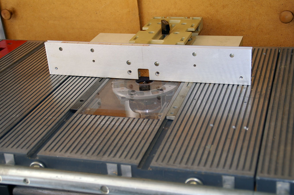

On a serious note, I went to Regal Plastics few days ago and picked up some Nylon sheet, 3/8" x 6" x 40". Made a sliding table using my old Incra jig and two mitre bars to slide in the slots of my homemade router table using a extra SS 510 table. Intent is to use part of the old nylon rack like a finger joint as redleg did. Did the extra ones he sent you work? Do you have any do's and don'ts you will share?

Attached is a couple of pictures of my old Incra jig rigged as a sliding table. Haven't attached the fence setup to attempt to cut the nylon rack.
[ATTACH][ATTACH]24726[/ATTACH][/ATTACH]
