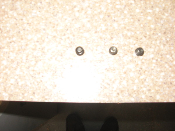

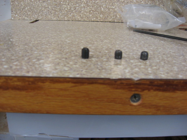

Dusty: will attach a couple of pictures.
Purchased two 510 blade arbors about a year ago.
no brass. All the attachments I have none have a brass
set screw.
The two on the right are blade arbor screws.
one on the left is for the drill chuck.:) :) :) [ATTACH]25447[/ATTACH]
[ATTACH]25448[/ATTACH]
Only the drill chuck set screw appears 'correct'. Not sure about the other two. Not clear re the points. They should also be 'flat'.

I can't see the two on the right well enough to judge. They appear to be the right length. The point is in question. They should be flats. If they are cupped or serrated, I would not use them in the arbors.
