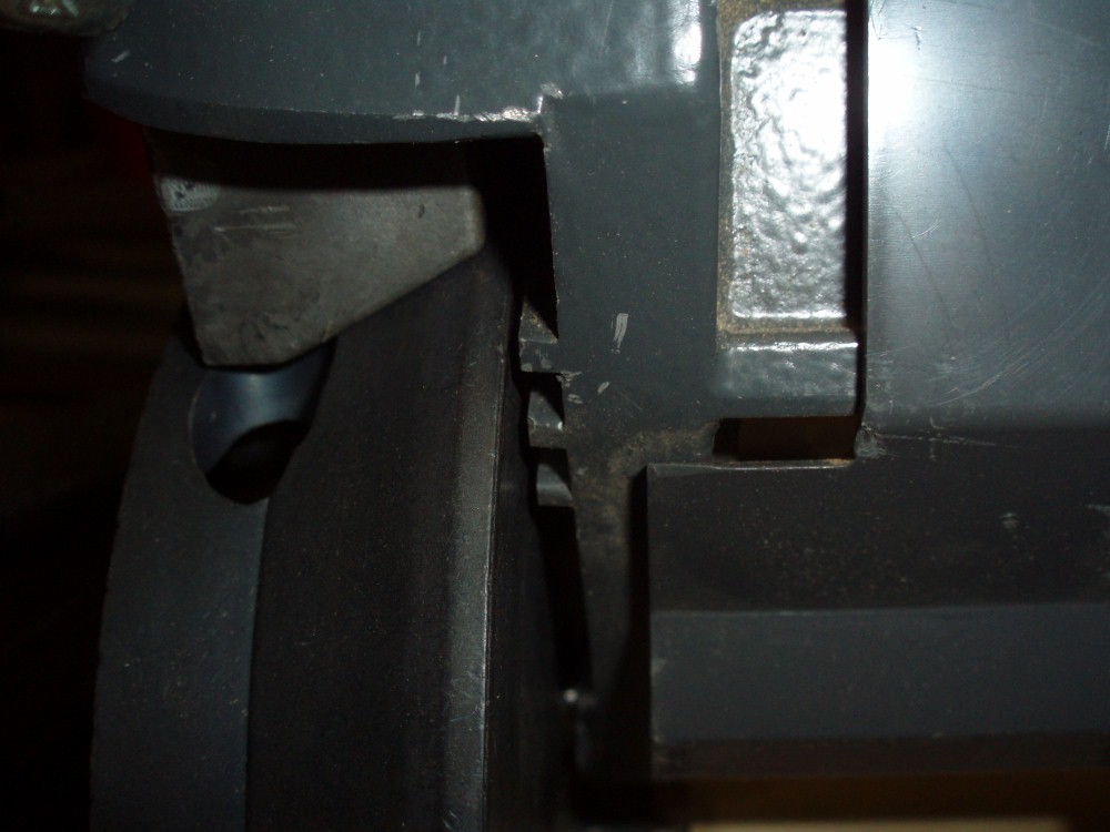

Over the course of my Shopsmith experience (25+ years) I have had my Main Work Table slip. I usually attributed this to having not properly secured the Table Tilt Lock and in a way I now suspect that that was the case. But, it likely was not because I didn't attempt to apply the lock.
I don't have this theory validated and I don't know exactly how to do that but I believe this next photo image, of a supposedly locked table tilt,tells the story.
[ATTACH]26759[/ATTACH]
That gap should not be there! To validate my theory I would need a sampling of table assemblies that slip as well as though that do not. I can not acquire that sampling so all I can do is pay attention to this gap when I do a table alignment and if the gap exists - redo it all. I believe the gap is a function of the the location of the rear trunnion when the table is secured.
I have some suspicion that that the oversized rear trunnion bolt holes contribute to the propensity of this to happen.
more to be added
more to be added

Shhh! Maybe Ed will miss this thread!:rolleyes:dusty wrote: . . .
more to be added
That gap looks bigger than what I would attribute to the 'hole enlarging'.

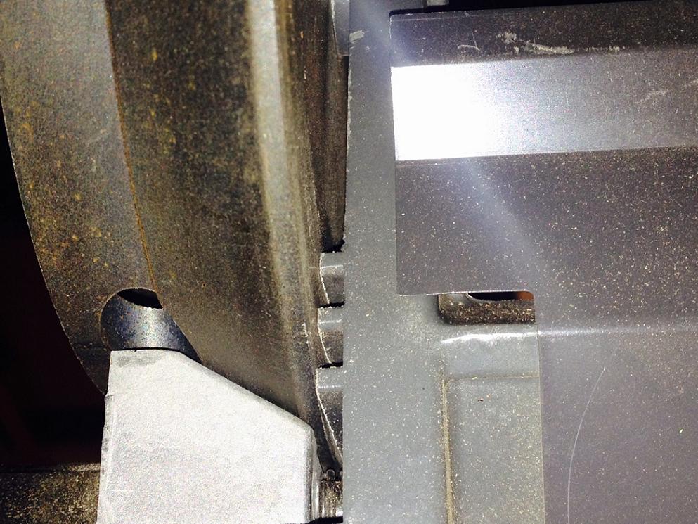

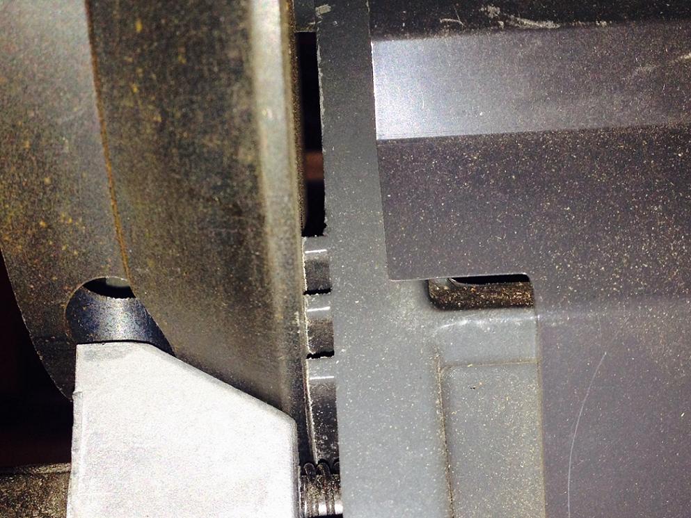

I'd say, "there's your problem!" By the way, I have "oversized" rear trunnion holes (which I redrilled). And here's what my tilt lock looks like locked.
[ATTACH]26760[/ATTACH]
[ATTACH]26761[/ATTACH]
P.S. Dusty, your picture is upside down!
P.P.S. There be light rust on my trunnion. Maybe I should wax it?

You might be right; probably are. The question I have now is how does one do the alignment while ensuring that the trunnions do contact the table bar.algale wrote:I'd say, "there's your problem!" By the way, I have "oversized" rear trunnion holes (which I redrilled). And here's what my tilt lock looks like locked.

Actually, it is not upside down:rolleyes::)
The table is upside down on the work bench.

[quote="dusty"]You might be right]
You've got the question wrong Dusty. The question is how one can do a table alignment and end up with the trunnions as far away from the table bar as in your photo. EDIT: Or maybe you've been using a dollar coin rather than a dollar bill for Nick's trick??:D
As I said in one of my posts, I would assume that with the table bolts loosened, applying the tilt lock would drive the trunnions flush to the table bar. That is unless the lock wedge is being held off by the little ledge shown in the photo I borrowed from Buckeye and annotated in a prior post in this thread.

The dollar bill is inserted in the 'front' trunion clamp.
Dusty's pix is of the rear clamp.
Question is, why is the rear clamp NOT against the rear trunion when the front is against the front trunion. AIUI, the clamps should both be squeezing the trunions as the clamp is tightened.
I believe the 0.005 shim is to assure the trunions do not drag against the pads at the rear due to non flatness of the trunion.
Gotta go look at my 510 table now.
Got to assume the .005 gap is split between the trunnions when the clamp is unclamped. Or am I wrong?JPG wrote:The dollar bill is inserted in the 'front' trunion clamp. Yes, but when the bill (or coin) is removed isn't the gap split between front and rear?
